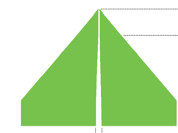

I have the following problem. In my device I have a stripline ( see attached picture) and want to apply an ac current on both sides (the two lines at the bottom of the picture). The currents should have a phase shift of pi, so that I get a current antinode at the top. But I have no idea how to apply an ac current.

Hello Thorsten,
Electrical circuit interface provides some nice functionality on this.
In the attached file, I've attached two ac current sources to two sides of a triangle, in a time-dependent solution. Is this what you wanted?

Hi Magnus
nice simple model, but I find it slightly confusing with all these different GND and extra terminals
Terminal 2 in EC can be replaced by a GND BC conditions (is equivalent to connect it to the default GND of CIR node "0"). Then one can disable CIR terminal 2 and the GND on "3". Furthermore the "gnd" on CIR node 4 is not required, one can replace the node "4" by node 0 which is GND in the CIR Terminal BC definition .
I see nothing "physically" wrong with your approach, I just find it excessively complex to analyse

Thanks Magnus and Ivar,
That is exacly what I meant. I've tried it, but I get no solution. There must be something wrong in my model and I have to admit that I don't understand the cir interface quite well. I've attached my model and hope you can correct my mistakes :)

first of all you do not really need the CIR physics, you can as well use the raw Terminal in MEF, use the "phasor" notation for complex excitation I0*exp(i*phase_in_radians)
Then I do not believe your time dependent solver in 10 steps over 1 sec is OK to resolve 1GHz signals ?
Why not use a frequency domain (harmonic) solver at 1GHz, you are normally working is steady state sinus excitation case, I assume or are you looking for transients ? anyhow then it's in the nsec range and not seconds you should choose for the time stepping
Read the doc about the harmonic solvers, and check a few model library examples its worth the reading ;)
Then at your frequencies you do not really need to simulate the "bulk" material thickness, current will flow in the surfaces anyhow, and with your nesh of only 1 element in the tickness you resolve nothing inthere. You will also gain the mesh size and solver time.
Finally check the mesh in your antenna region, I would have used a higher density at the antenna junction

Thanks Ivar
Now it works ;)
