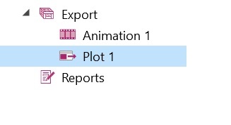

Sounds like you just need to get some more practice with post-processing and exporting of plots and data. You can make surface plots, line plots, point plots, etc. And you can export them in various ways. Since you are working in 2D, it sounds like you want the values along a line. So create a line plot, set it up so that the plot shows the data in terms of the quantities of interest to you (e.g., Ez vs. x, or something like that), and then export that data as a plot or data. With a little practice and a willingness to experiment with the various choices available to you, you will be very likely to succeed.
Sounds like you just need to get some more practice with post-processing and *exporting* of plots and data. You can make surface plots, line plots, point plots, etc. And you can *export* them in various ways. Since you are working in 2D, it sounds like you want the values along a line. So create a line plot, set it up so that the plot shows the data in terms of the quantities of interest to you (e.g., Ez vs. x, or something like that), and then *export* that data as a plot or data. With a little practice and a willingness to experiment with the various choices available to you, you will be very likely to succeed.
