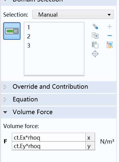

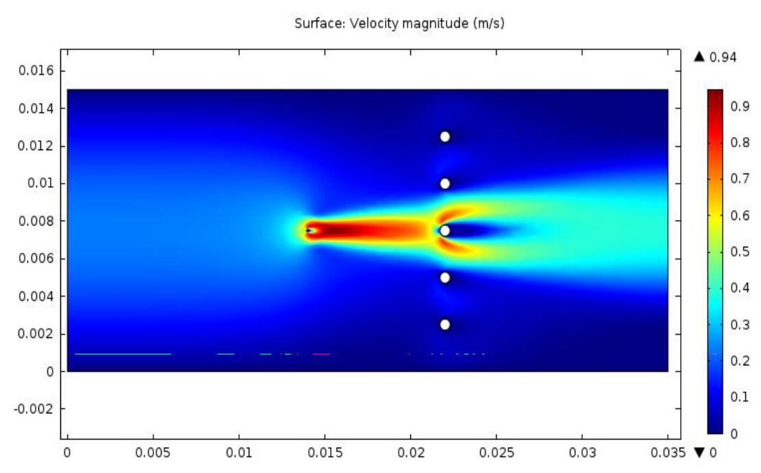

The following pictures 1 and 2 show the model I made. I found that after adding the volume force, the entire watershed will have a velocity field. I don't know how to make his effect.
