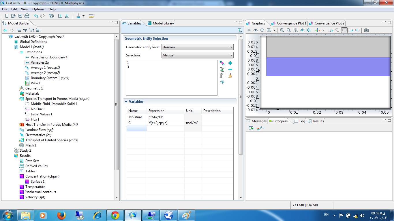

Here is one trick to solve negative concentrations.
I made variable "C" which is defined by "if(c<0,eps,c)" under Definitions => Variables. Instead of concentration "c" I used variable "C". Now variable "C" is never below zero. Eps is very small number defined is Comsol.
Does this help you?
Best regard
Tero

Thank you. Your method seems available. But if another condition that the concentration value exceeds the expectable largest value also occurs, how to set the variable C? That is, if c<0, c=eps; if c>1, c=1. Please help me. Thank you again.
Does this help you?
Best regard
Tero
Thank you. Your method seems available. But if another condition that the concentration value exceeds the expectable largest value also occurs, how to set the variable C? That is, if c1, c=1. Please help me. Thank you again. [QUOTE] Hi, Here is one trick to solve negative concentrations. I made variable "C" which is defined by "if(c
Posted: 1 decade ago 2012年6月26日 GMT+2 14:35
Try this: if(c<0,eps,if(c>1,1,c)).
Best regards
Tero
Does this help you?
Best regard
Tero
Hi Tero
I try this for species transport in porous media but my finally concentrations are negative. my problem is unsteady.
Best regards
Posted: 1 decade ago 2014年4月11日 GMT+2 12:30

Posted: 8 years ago 2017年5月2日 GMT+2 12:47
I know it is in response to your very old post. But I also have the same negative concentration. And I am not able to incorporate the trick you suggested in this post. How do you have 2 variables for concentration c and C?
Hi, I know it is in response to your very old post. But I also have the same negative concentration. And I am not able to incorporate the trick you suggested in this post. How do you have 2 variables for concentration c and C?
Posted: 8 years ago 2017年5月5日 GMT+2 08:56
I haven't use Comsol for ages but I try to remember how this was done.
Yes, I have two variables where "c" is Comsol own parameter and "C" is new variable for calcuation purposes. "C" is used in reactions to prevent negative concentration and it is never below 0.
Did this answer to your quoestion?
Best regards
Tero
Hi, I haven't use Comsol for ages but I try to remember how this was done. Yes, I have two variables where "c" is Comsol own parameter and "C" is new variable for calcuation purposes. "C" is used in reactions to prevent negative concentration and it is never below 0. Did this answer to your quoestion? Best regards Tero
