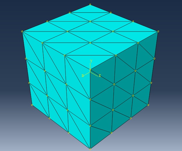

i have attached 1 jpeg file in that 'x' [set of all node of x=1 plane except common node (1,1,1)].
similarly i have apply linear constrain in y=1 and z=1 surface of cube.
how can i apply same constraint in comsol.

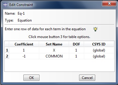

thanks for reply
i have attached the document.
can i able to do same in comsol (i.e momentum equilibrium)
the thing i mention in attachment is what exactly achive by contraining node set.
thanks for reply i have attached the document. can i able to do same in comsol (i.e momentum equilibrium) the thing i mention in attachment is what exactly achive by contraining node set.
