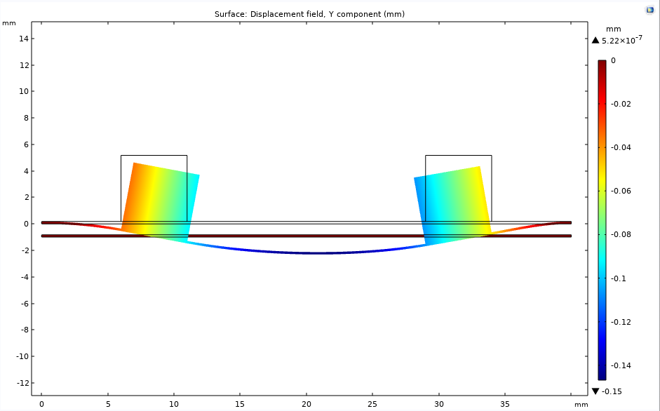

I have a relatively simple 2D model in which a force is applied to an object which will make it deform and come into contact with another object (base). I would like to measure the contact pressure applied by the deformed object onto the stationary base.
I have set up the contact pair under definitions and then added a contact pair in the physics node, yet my top object is still passing through my base, shown in the picture below.
Can anyone advide me how to fix this issue? I have attached my model for anyone interested in looking.

This is a visualization effect. Set the scaling factor in the deformation subnode to 1 and you will see that the contact pair is far from touching each other.

Thanks Edgar, I didn't notice this. Once I up the forces so it would be in contact with each other i get an error saying it failed to find a solution. Is this a meshing issue? Or something incorrect with my physics set up?
