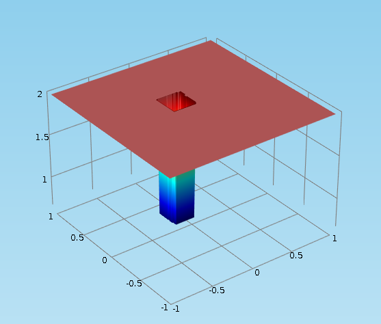

I have what I think is a very simple problem. I would like to define a 3D geometry from a JPEG/PNG image.
What I have tried., reading the forum as well as examples such as Mount St Helen, Rock Fracture and a few others.
What I do at the moment is;

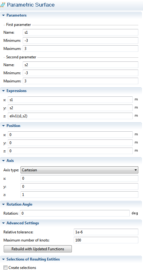

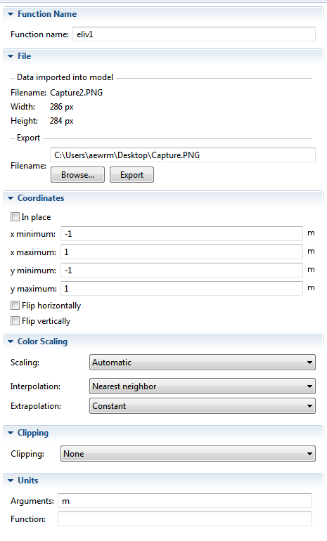

1) create an image in the definitions.
2) create a parametric surface in the geometry (I have included screen shots to illustrate).
However, I do not appear to be able to generate the surface at all. Have I done something silly?!
I am sure this would only take a moment or two for someone who has used images as the basis for a surface to be able to help. I have been able to create a 3D surface using the interpolation function where I define the grid but this is going to be more involved than doing it directly.
Many thanks for your help,
Rob

Hi everyone,
I think I may have solved the problem, kind of.
The issue was resolved by defining the image in Global Definitions not the Model Definitions. Once I did that the image and the Parametric Surface worked.
I am still trying to figure out exactly how to use it, but I am getting there.
