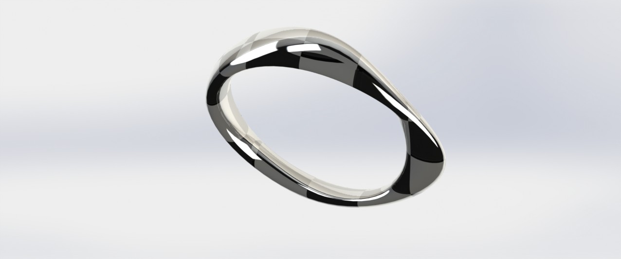

Well the whole concept of a Mobius strip *is* that it has only one side. The Parametric Surface way gets us to a domain that indeed is three dimensional and has only one face. It is very interesting in seeing how Comsol treats that, since one of the traits such a strip has is that it is has no direction topologically, if I am not mistaken.
anyway, I managed to import it to comsol with a ".x_t" file eventually; can't attach the file I imported, but attached a picture.
I tried to simulate something very very easy and light with it, and it started getting lengthy already, so I let it run for the night. Tomorrow morning we'll see what's going on.
Well the whole concept of a Mobius strip *is* that it has only one side. The Parametric Surface way gets us to a domain that indeed is three dimensional and has only one face. It is very interesting in seeing how Comsol treats that, since one of the traits such a strip has is that it is has no direction topologically, if I am not mistaken. anyway, I managed to import it to comsol with a ".x_t" file eventually; can't attach the file I imported, but attached a picture. I tried to simulate something very very easy and light with it, and it started getting lengthy already, so I let it run for the night. Tomorrow morning we'll see what's going on.

So it appears that Comsol is not quite compatible with the Mobius Strip ;)
I attached my model; it seems that solution never converges. I tried Point Charge, I tried Surface Charge Density, and I tried more; The convergence graph looks like noise every time.
I will now try the same with Triangle- and Square-based mobius rings.
So it appears that Comsol is not quite compatible with the Mobius Strip ;) I attached my model; it seems that solution never converges. I tried Point Charge, I tried Surface Charge Density, and I tried more; The convergence graph looks like noise every time. I will now try the same with Triangle- and Square-based mobius rings.

You are right Magnus, now that I'm back in my office and can load the model, for me this is a skewed torus hence still in standard 3D topology, by removing the interiour and charging the torus boundary and setting a GND you get a results.
I had in mind a 2D strip Moebius boundary in the middle of a sphere, hence the up and down are superposed ;) but I do not really see how to make one on those with the COMSOL geometry
Hi You are right Magnus, now that I'm back in my office and can load the model, for me this is a skewed torus hence still in standard 3D topology, by removing the interiour and charging the torus boundary and setting a GND you get a results. I had in mind a 2D strip Moebius boundary in the middle of a sphere, hence the up and down are superposed ;) but I do not really see how to make one on those with the COMSOL geometry -- Good luck Ivar
