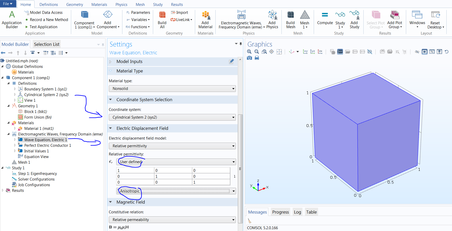

there are a few ways:
a) you define your materials properties (nodes) accordingly
b) you define it in the Physics sub node
Normally anisotropy is defined with respect to a given coordinate system that might not be the default Cartesian one of your model, therefore often you must also define a Coordinate system and refer to the correct coordinates, which might by something like sys2.r, sys2.phi ...
As I find it very easy to get the anisotropic coordinates wrong, I do always plot the new coordinate system and the tensor values in a specific dedicated plot, for that you must set up your Solver, do an "Get Initial Values" and make a coordinate plot + a plot of your tensor values in the desired coordinate system

Thanks Ivar for your message. Please see the attached file, you may come to know what exactly I want to do. It will be better if you show me an example on how to change the coordinate system and then define tensors. I have seen last file from you and it helps me a lot.
I want to study the behavior of electromagnetic wave at the interface of two different media, one is isotropic and the other is anisotropic. Please do more discussion with me.
