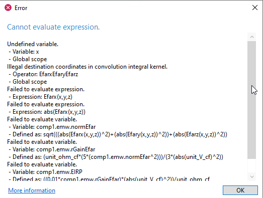

One thing that I don't understand is that when I tried to evaluate emw.EIRP (to compare it with emw.Pport1 and see if this time it does work) I get an error:
This happens already at the base file (the one you can download through the Application Library)... Is this normal? Is it due to some step along the way?

EIRP is also not a global variable but a spatially dependent variable. You can only evaluate it at spatial coordinates. EIRP is the amount of power you'd have to transmit with an isotropic antenna to get the same signal strength in that far field direction as your current antenna. So if you have at some theta/phi coordinate an EIRP of 10W while you only transmit 1W you have a total antenna gain of 10 times at that direction.
