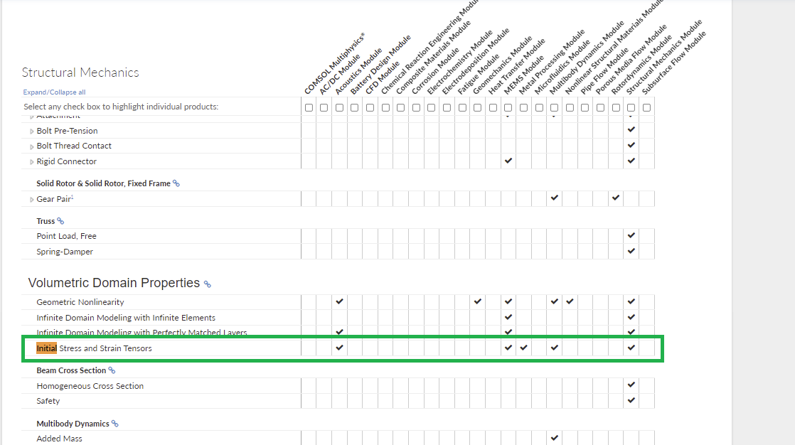

Hello Megan,
The Specification Chart can be used to determine which module carries the functionalities your modeling requires. If I understand your post correctly, you are in need of the "Initial stress and strain tensors" capability; if so, the attached screenshot shows which modules carry it. The Structural Mechanics Module is one of them, but it is not the only one.
Hello Megan, The [Specification Chart](https://www.comsol.com/products/specifications/#) can be used to determine which module carries the functionalities your modeling requires. If I understand your post correctly, you are in need of the "Initial stress and strain tensors" capability; if so, the attached screenshot shows which modules carry it. The Structural Mechanics Module is one of them, but it is not the only one. Best regards, Jeff
