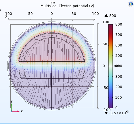

HI, i have two parts in a chamber where one has potential and the other is grounded.
Anyone has any idea how to altternate the electric potential from +800 to -800 with respect to ns?
Kindly find the pic for reference.

Hello Ajay,
See, for instance, this thread.
Hello Ajay, See, for instance, [this thread](https://www.comsol.com/forum/thread/225851/how-to-increase-a-load-in-a-physical-time?last=2019-01-17T16:37:36Z). Best, Jeff
