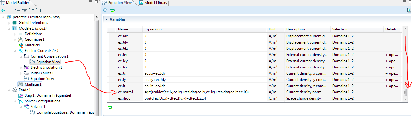

turn on the equation view (Options preferences) and look at the definition of the COMSOL internal variables, in this cas it is the norm (sqrt(Jx^2+Jy^2+Jz^2)) of the current density, the formula is "complex compliant" by the "realdot()" operator that is just there to correctly get the scalar value for complex current densities (typically AC cases)

Thank you. I have equation view switched on, but I do not see that; never mind.

I find it nicely in my 4.3 ;)
