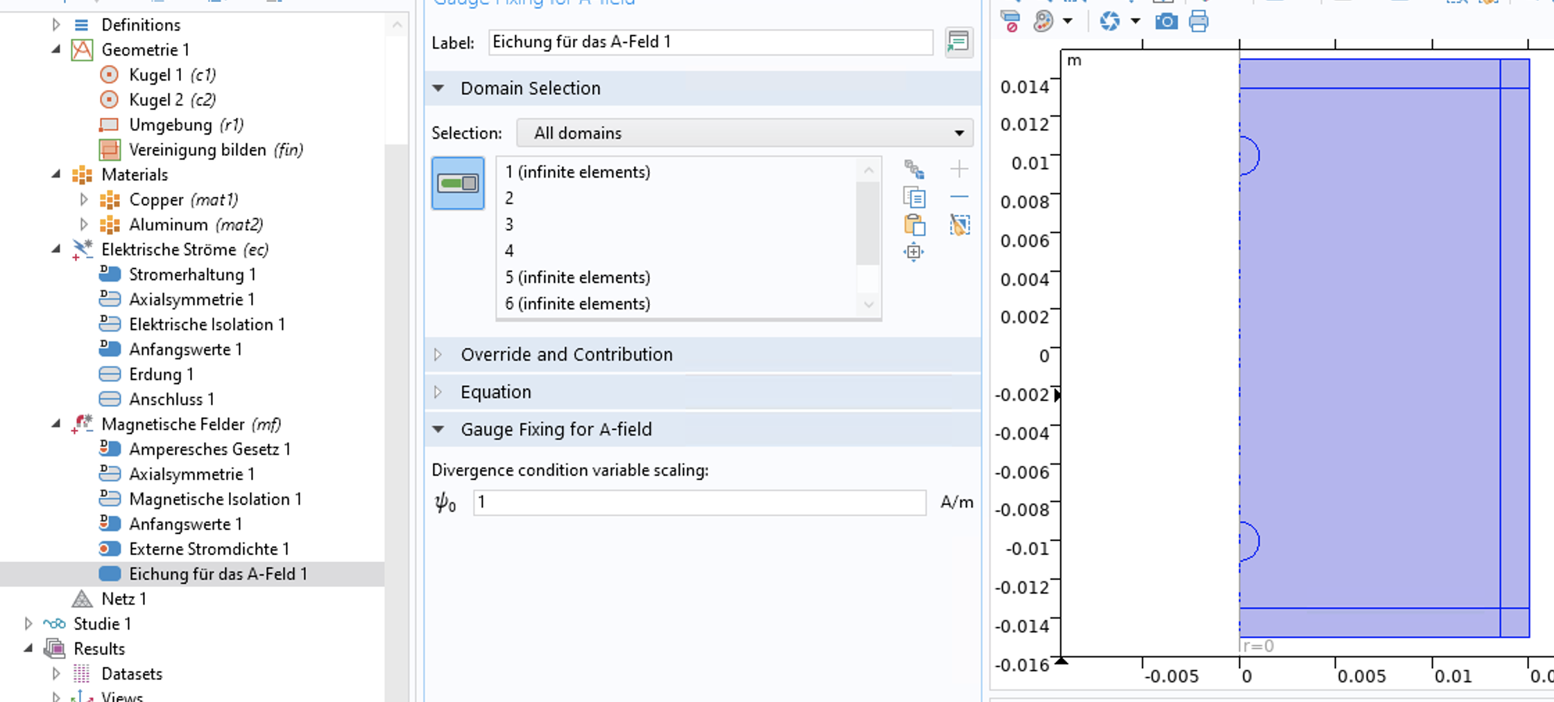

i have the task to simulate the magnetic field between two spheres. The enviroment of these two objects is a electric conductive material. I choose a 2D-axis component, you can see on the attached file.
For the physics i combined "mf" and "ec". The first step of the simulation is to generate the current in the system (ec). That was no problem. With the terminal- and ground- selection option is a current, also a current density in the modell avaible.
After this step, the results of step 1 were used for the current density at the selection option "external current density" (mf). I embeded every direction (r, phi, z).
I thought the problem of not getting a magnetic field was the gauge fixing. The magnetic vector field is In-plane, so i get the option "Gauge Fixing for A-Field".
I don't know what the problem is, the 2D-plot with mf.normH is empty.
Have someone suggestios what i could change at my simulation?
Markus
1 Reply Last Post 2022年7月3日 GMT+2 23:08
Posted: 3 years ago 2022年7月3日 GMT+2 23:08
If the current is primarily along the symmetry axis between your two spheres, then the magnetic field vector is in the azimuthal direction. That direction is perpendicular to an "In plane" magnetic field. With that in mind, did you formulate the problem correctly?
