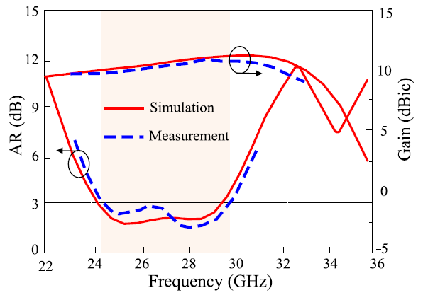

How to plot gain and axial ratio in frequency?
'Gain' is defined on angles, however many papers show gain in frequency. Same for other antenna parameters such as 'axial ratio'.
I couldn't find an example in application libraries that COMSOL supports. Are there any fast ways to plot the spatial dependent antenna parameters in frequency?
I attached an example figure.
