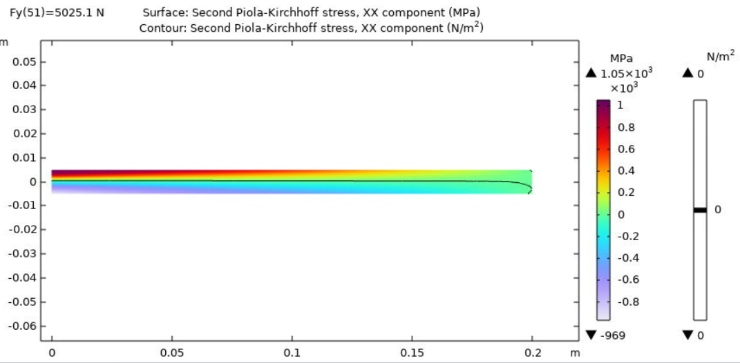

I have tried using a contour plot of the stress (in my case I am using the second Piola-Kirchoff stress (solid.SXX)) and I set the levels to zero in order to find where the stress is equal to zero. This would give the position of the neutral axis. However, since I am not really clear on how COMSOL is averaging the stresses on the backend, I am not sure if this approach is correct. And I feel that it is also highly mesh dependent. I am currently using an extremely fine mapped mesh instead of the default free triangular one.

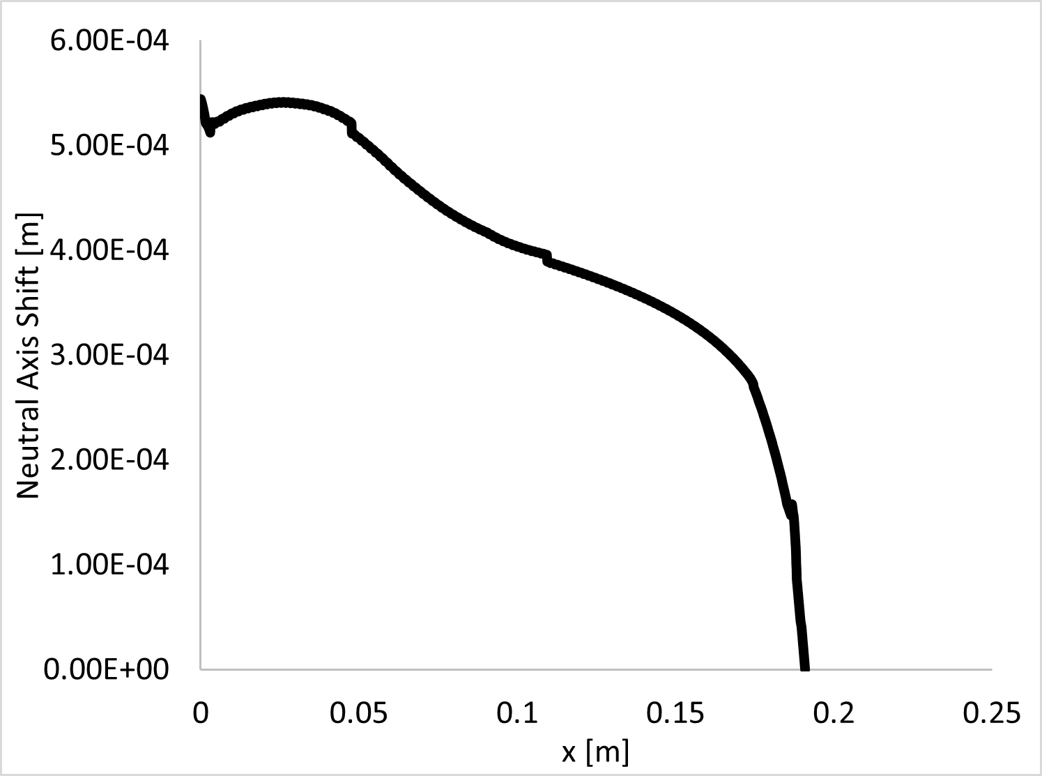

I am finding that since there may be stress singularities especially at the tip of the beam where the force is being applied, the results I am getting may not be accurate. The image attached shows that for a very large tip force, the neutral axis shift drops to zero towards the end of the beam. I'm assuming because there are also artifical stresses that equal to zero at the top and bottom of the beam where the force is applied, and the model is lumping those stress levels together. From my analytical model, it should be a constant value after a certain level of stress.

I think your idea if using the contour value for zero solid.SXX is a good approach. I would not be too worried about the exact stress evaluation/interpolation, as long as you have a reasonable mesh. No need to make it extremely fine.
Now to your problem. By looking at the plots, my guess is the following:
Your load at the beam end may be pointing in the space-fixed negative Y-direction. At larger displacements, that will be not only a bending load, but also partially a tensile load, due to the rotation of the end of the beam. That could explain why your neutral axis drops. We know from beam theory that the rotation increases quadratically along the beam, so the effect should be much stronger as we approach the tip. At the same time, the bending moment is smaller there (varies linearly inwards).
Under these assumptions, I think a first order estimate for the neutral axis location is proportional to x^2/(L-x), where x is the coordinate along the beam (length L). That looks a somewhat like your results.
Finally, if you want as little as possible influence of the load application, distribute it parabolically like (h/2-y)*(h/2+y), where h is the beam height.

I could tell from my results that the force at the end was influencing the location of the neutral axis, but I didn't quite understand why. But, your explanation helps me a lot. And correct, I am applying a boundary load in the negative Y direction at the end of the beam. I'll have to refresh my understanding of beam theory since there's a lot of assumptions I make in my analytical model ignoring the tensile load due to the applied force, which is probably not neglected in COMSOL.
I will try your suggestion of the distributed load and see how it works out.
