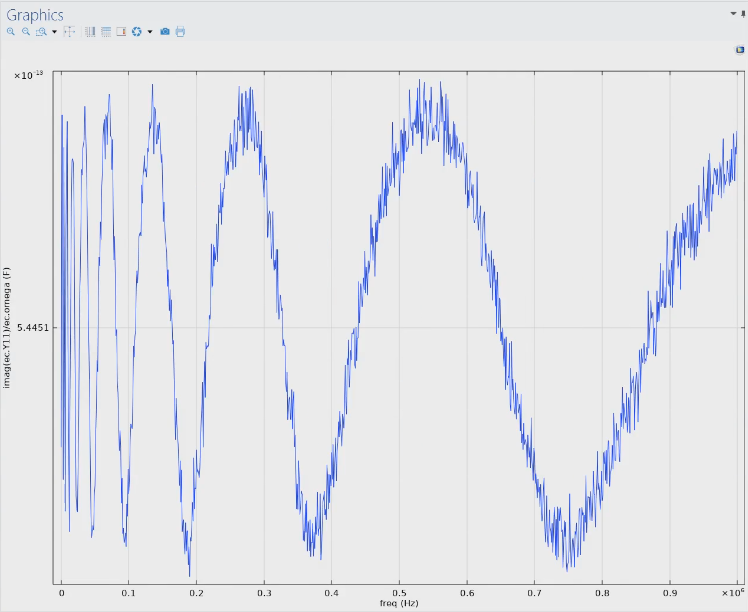

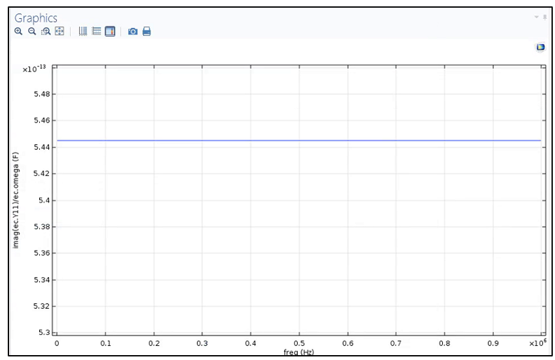

Hi, I got this plot 1. However, Reopening the comsol file gave me plot 2. Although, two plots data table is simialar, its appearance is different. It seems the scale of plot 2 is not similar to plot 1. How can I get similar plot like plot 1 again? TIA

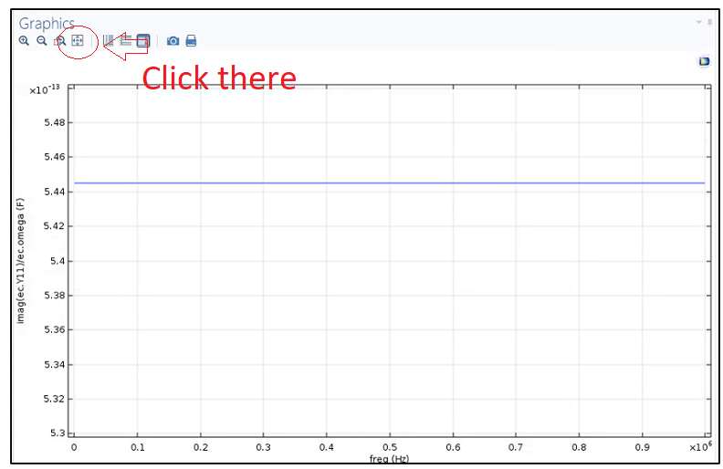

See figure attached.
Thank you Robert for answering. But, it is not working this way.
>See figure attached. Thank you Robert for answering. But, it is not working this way.

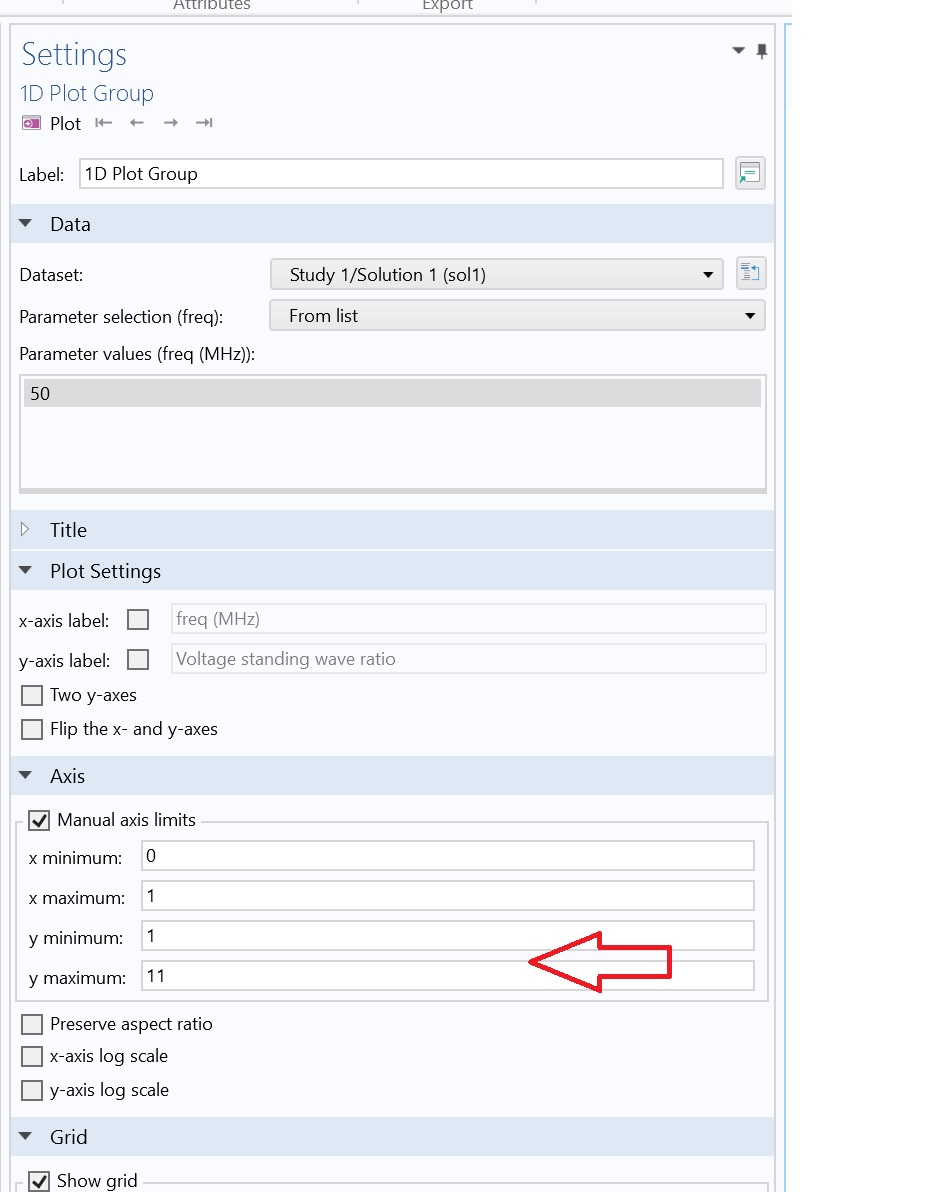

Oh, I misunderstood your question! I now see that you wanted to see the plot without all the detail! When you replotted the file, it automatically scaled it (to show you the detail). If you don't want that, then set the min and max values of the y axis manually. You will find those in the various plot settings. See example attached.
Oh, I misunderstood your question! I now see that you wanted to see the plot *without* all the detail! When you replotted the file, it automatically scaled it (to show you the detail). If you don't want that, then set the min and max values of the y axis manually. You will find those in the various plot settings. See example attached.
