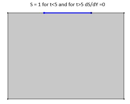

I am currently using the Coefficient form PDE module in COMSOL Multiphysics to solve for the saturation distribution in soil. I am facing an issue where I need to apply a saturation of 1 for the first 5 seconds and then switch to a zero flux boundary condition at that boundary.
Boundary conditions are as follows: **S = 1 for t<5 dS/dY = 0 for t>5 **
I would greatly appreciate any insights or advice on this issue. Thank you in advance for your help.
