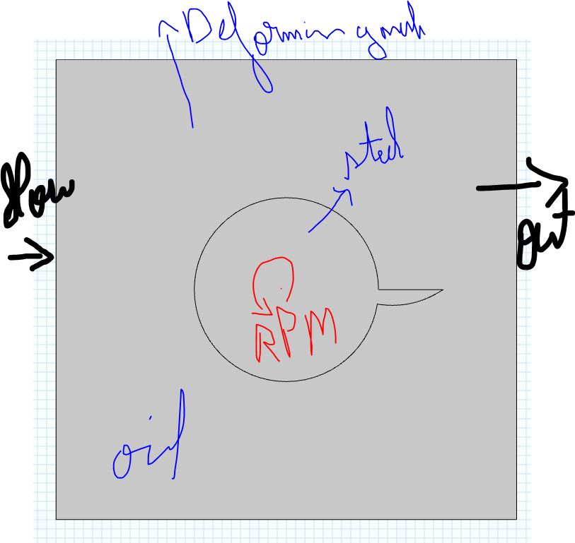

Hi, I would like to ask for help, I need to model a fluid structure interaction in comsol, in which I have a fan in water, and would like to know how to model the fan rotation, without using moment I need to use RPM. The used physics are laminar flow, and multibody dynamics! The picture describing my work is attached to this question.
