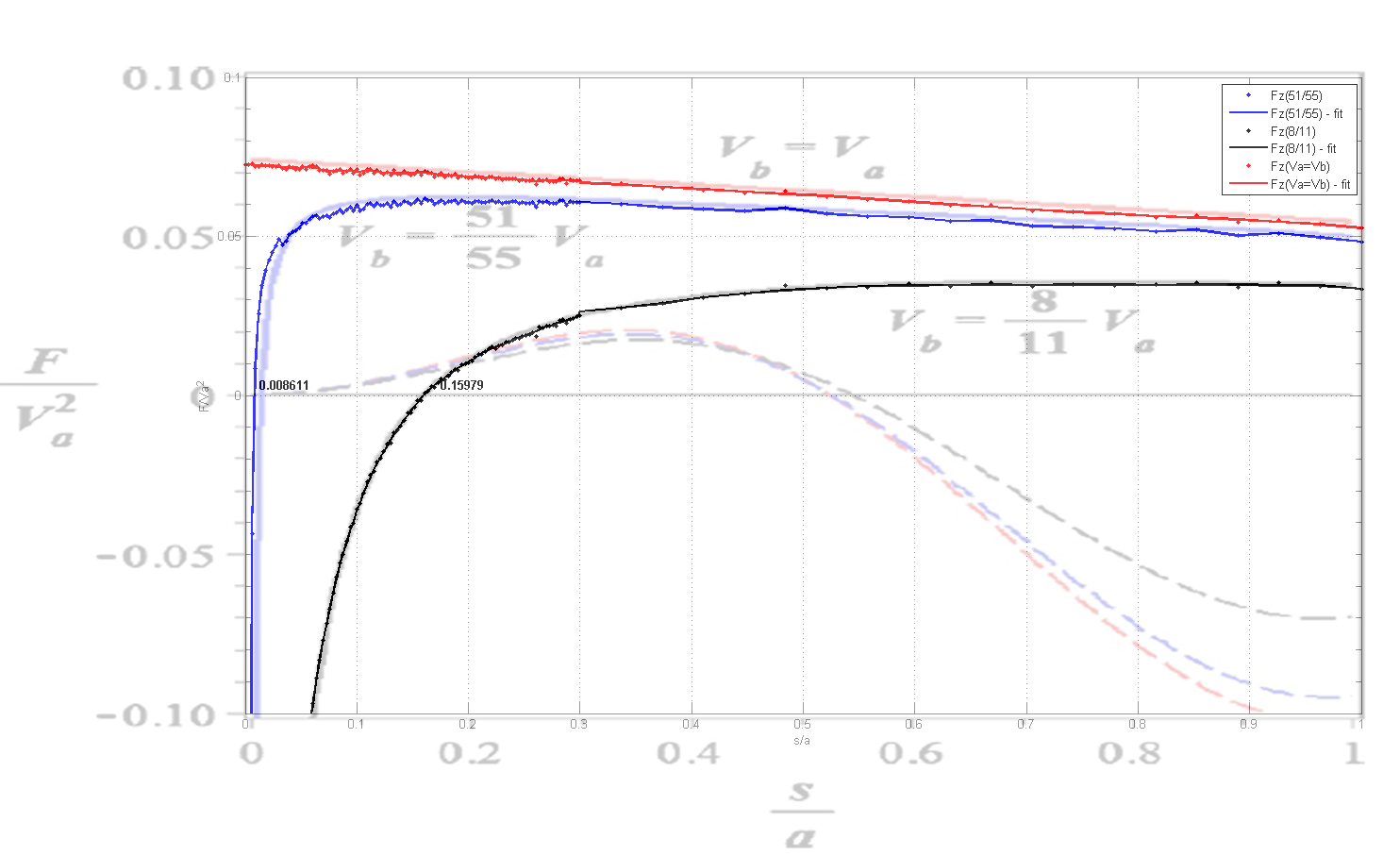

Hello again,
I have successfully recreated the desired results with only one difference. They are off by a factor of 2, i.e. twice as big as in the article. In the attached picture are my results(divided by 2) photoshoped over the graph from the article. They align as they should.
Now I cannot find the reason for the factor of two. I tried rebuilding the model, different parameters, mesh sizes; the results are always the same. Then I tried to calculate the force manually via integration of the Maxwell Stress Tensor: the same.
We contacted the author of the article, and he suggested we calculate the forces for a large separation between spheres. We did and we compared them to a calculation for a force between two charges, which should be a good enough approximation for a large separation. Yes, they are also off and the results divided by 2 align perfectly.
Any ideas about this?
Tomo
Hello again, I have successfully recreated the desired results with only one difference. They are off by a factor of 2, i.e. twice as big as in the article. In the attached picture are my results(divided by 2) photoshoped over the graph from the article. They align as they should. Now I cannot find the reason for the factor of two. I tried rebuilding the model, different parameters, mesh sizes; the results are always the same. Then I tried to calculate the force manually via integration of the Maxwell Stress Tensor: the same. We contacted the author of the article, and he suggested we calculate the forces for a large separation between spheres. We did and we compared them to a calculation for a force between two charges, which should be a good enough approximation for a large separation. Yes, they are also off and the results divided by 2 align perfectly. Any ideas about this? -- Regards, Tomo
Posted: 1 decade ago 2012年10月31日 GMT+1 20:47
which version are you using?
if I remember right there was a factor 2 missing in some ACDC internal variables in the early 4.0, could it be that ?
Hi which version are you using? if I remember right there was a factor 2 missing in some ACDC internal variables in the early 4.0, could it be that ? -- Good luck Ivar
Posted: 1 decade ago 2012年11月5日 GMT+1 11:23
I am using 4.3.
It seems that I have managed to eliminate the problem. I really don't know what the problem was, but I rebuilt the model once again and now the results are correct. I can not find the difference in the models, but one of the two gives the correct results and the other one does not. I must have made some mistake somewhere, because after another rebuild the results are still correct.
Anyway, thank you for your help. I will try to triple-check in the future before posting here.
Tomo
I am using 4.3. It seems that I have managed to eliminate the problem. I really don't know what the problem was, but I rebuilt the model once again and now the results are correct. I can not find the difference in the models, but one of the two gives the correct results and the other one does not. I must have made some mistake somewhere, because after another rebuild the results are still correct. Anyway, thank you for your help. I will try to triple-check in the future before posting here. Regards, Tomo
