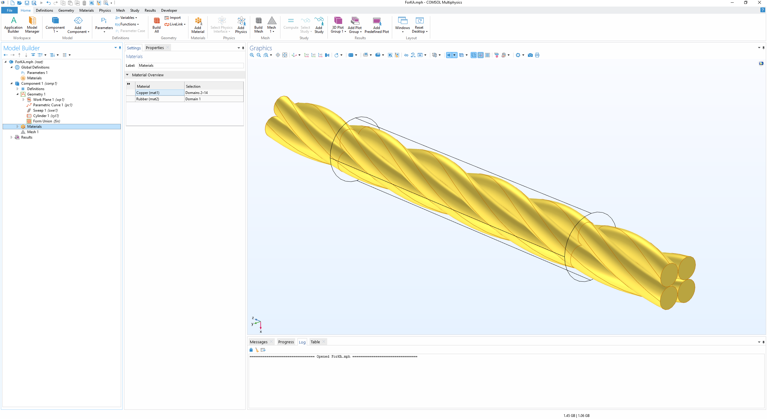

Drawing the geometry in 3D is a very straightforward of standard COMSOL drawing techniques. Basically you draw a cross section in a workplane and then sweep it along a helix.
I would recommend you seriously consider Dave's comment before you go the 3D route. If the information that you want to get out of your simulation is such that it is possible to replace the real geometry with a solid wire, then things will be way easier to set up and less computationally expensive. Dave - I hope I am not putting words in your mouth :)

- It is cheerful to know that the corresponding 3D drawing is "straightforward". Attached it is my primal trying to build the geometry (a set of Helix wrapped around each others). It is a bad geometry containing areas overlapping, void spaced, tiny vertices, etc. For that I could not properly assign "Material" for the Helix (i.e., representing the filaments).

Here you go!

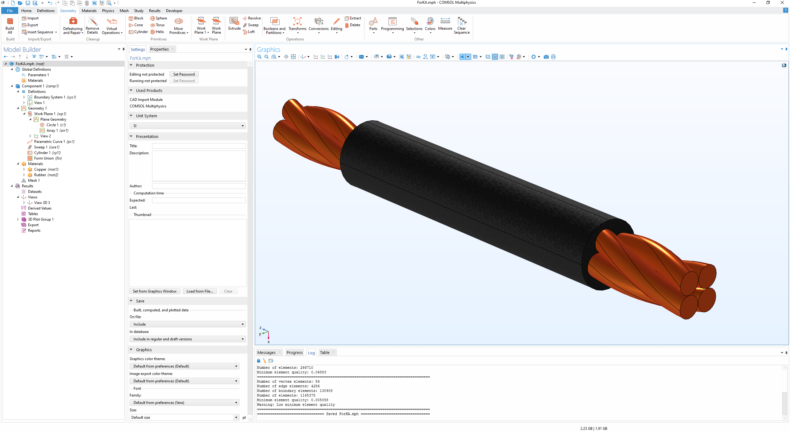

Hi Jeff,
Thank you for providing a complete model.
Although the resulting geometry "looks" like the orginally attached Stranded Wire V1, but when tried to assign each of the filament to a Coil it turned out the the filaments exist actually only on the borders of the Rubber (cylinder). Please take a look at "geo".

Incorrect. The filaments exist throughout.

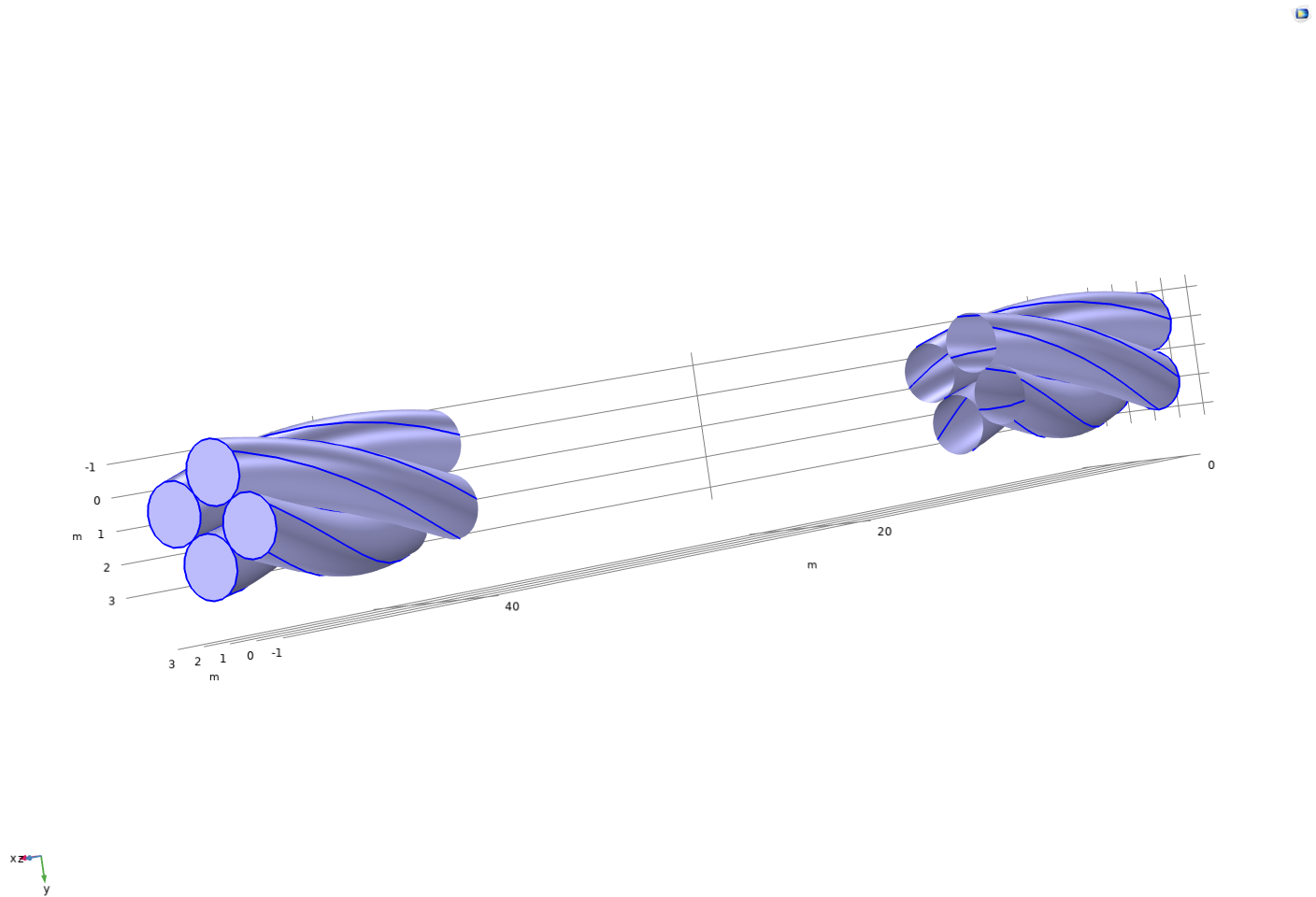

- how to "scale down" the dimensions of the filaments? i.e., the diameter of each filament is to be of 5 mm instead of 1 m , having the length of 1 m.
- how to "add" more circles (i.e., primitives of the filaments before being "Swept" around the parametric curve) with respect to your rectangular array? For example, instead of 4 filaments, I wish to have 7 filaments, arranges in 3 rows: first upper row of 2 filaments, cenetered row of 3 filaments, bottom row of 2 filaments (as in Stranded Wire V1.jpg).
- in "ForKA.mph" - despite it is composed of only a 4-filament wire and we intend to make it a 7-filament instead with a scaled down geometry - you can clearly see a "gap" or in other terms a "hole" or "space" between the 4 filaments:
a. is it possible to adjust the parametric curve so that the 4-filaments are more closely twisted together without any void in between?
b. the logic in a. is to be also applied to the intended 7-filament design
- I have attached a 7-filament twisted geometry design (helped by a colleague of you from COMSOL) but with inappropriate dimensions (circle radius is of 1 m): when 1. and 2. are hard to establish, you can kindly use the attached .mph file in order to reply to those comments.
