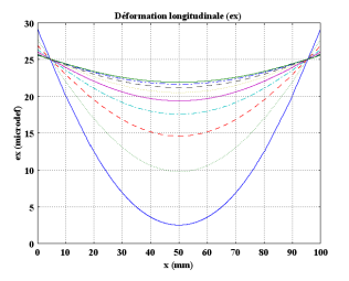

           Hello Hamza,
           Your question is unusual in that you seem to know what part of the solution is and are asking what the assumptions in the model should be to yield that partial solution; an inverse problem. This makes me think that you are perhaps trying to replicate work done by others, a paper maybe? Since there is not a unique set of boundary conditions that a partial solution can be traced back to, your question unfortunately does not have a unique answer: you could come up with several sets of boundary conditions all consistent with the known partial solution. My best advice would be to contact the authors of the work you are trying to replicate; they should be able to tell you what BCs they used. Short of that, you may be able to deduce some reasonable guesses from the rest of the paper and try them out.
