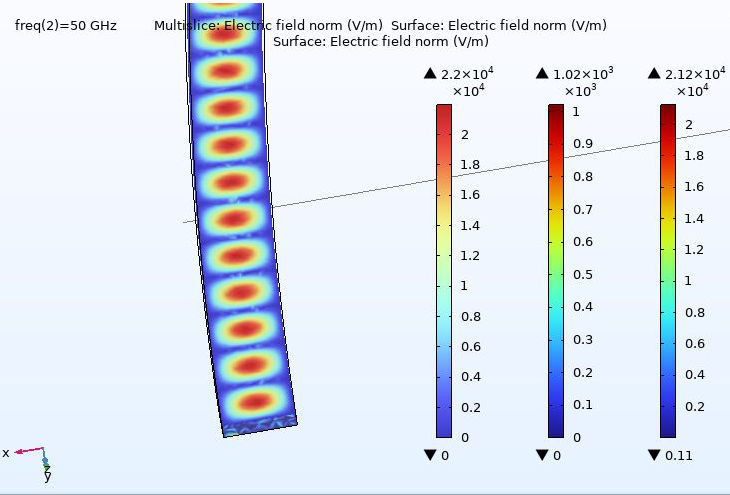

I am simulating mode conversion ( TE10 to TE20) on a hollow curved waveguide of rectangular section. On the Port section I inserted Phase=0 for both ports (input and output). I don't understand why on Port 2 (the output Port) the field is always (almost) vanishing even if I change wavelength, i.e. exp(ikz_port2)=0 (where z is the direction of the waveguide axis). Intuitively I would expect that, based on the relation bewteen wavelength and length of the guide, on Port 2 the solution would change the value of the exponential part (i.e. the part propotional to exp(ikz)). Why this behaviour?

I followed the procedure you indicated me, but unfortunately the emw.S41dB parameter is -inf (this would indicate zero trasmission of TE20 to output port and it seems strange). I attach the .mph model (I cleared mesh and solution but the model is very fast to run)
In your waveguide, the cutoff frequency for the TE20 mode is 52.7804 GHz. You were running your model at 50 GHz. This isbelowthe cutoff frequency, so TE20 will not propagate. Either make your waveguide wider or run your model at a higher frequency, if you want to allow the possibility of a TE20 mode to appear.

I now would want to understand the attenuation of my modes due to Ohmic losses given by the material (copper) which surrounds the waveguide. For a first try I modeled a WR42 straight Wg of 0.5m and I used the Impedence boundary condition to simulate Ohmic Losses. From what I understood, the attenuation is quantified (for a given mode) by the beta attenuation coefficient. From the solution I obtain 4 beta coefficient (but I have two modes, i.e. TE10 and TE20), and the coefficient beta1 (which I expect to be related to TE10 attenuation) is very large resulting in a fast dissipation of TE10, which is not seen in the E-field pattern where TE10 seems dominating. Is my error in the interpretation of the beta coefficients or in some setting of the model? You find the .mph model attached
