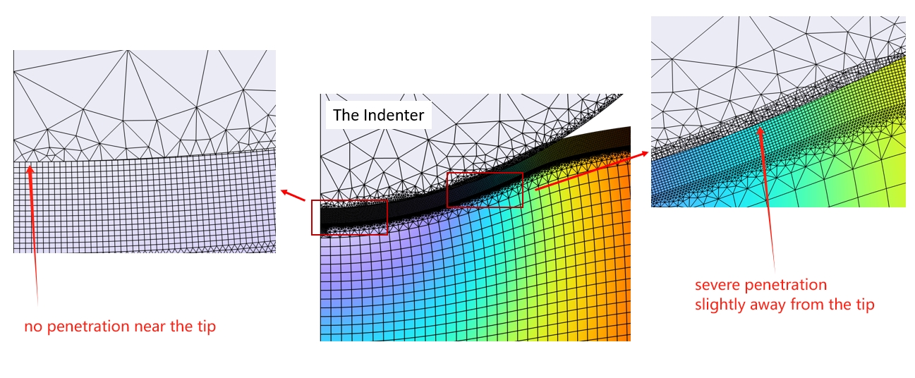

I am working on the modeling of a elastic homogeous material indented by a rigid indenter, spherical or conical.
The indenter is model by rigid material, and the contact is defined through contact pair. The indenter and the elastic material is put together through 'form assembly'. The 'segregated augmented Lagrangian' method is employed, with preset penalty factor control tunned for speed. The prescribed displacement increases cubically (the model file of an isotropic elastic trail run is attached)
However,severe penetration occurs slightly away from the indenter tip(see the attached figure).

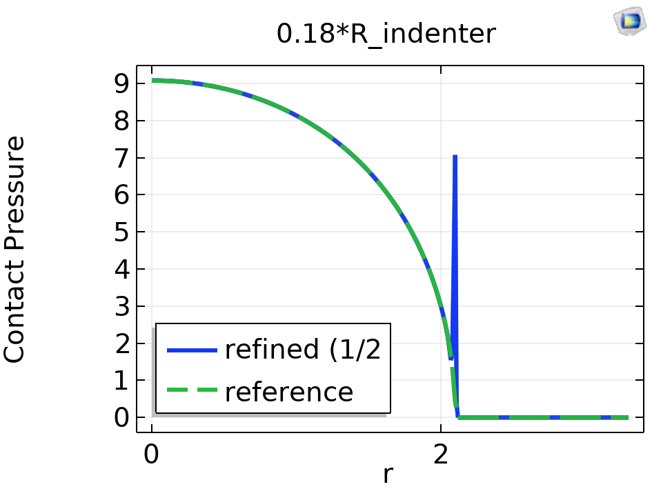

About the mesh refinement, I encountered another problem. Sometimes, I have to refine the mesh. Otherwise, the derived 'indentation modulus v.s. depth' curve isn't smooth.
But when the mesh is refined,the distribution of contact pressure becomes bumpy near the contact edge(see the figure below or the attached graph). The contact pressureincreases and decreased suddently by a vary large extent. Could you give me a hint about this?
attached figure

The calculation time apprximately doubled. I can see from the Convergence Plot that the Error is below 1E-4 now, butthe Graphics view still gives a penetration plotand no appreciable change can be observed.

The deformation plot doesn't change. The penetration still occurs.

The bumpy result: This is may be a plotting artifact, but it also possible that there is an unconverged solution. Start by switching off 'Refinement' and 'Smoothing' in the plot so that you can see the raw data. Zoom in on the region with the bump. The contact pressure is represented by a linear shape function over each element.

I checked the overall results, e.g., the derivated indentation modulus. It matches the prediction of related theories, though there are penetration and bumpy contact pressure.
About the penetration, is it possible that the peneration is also a plotting artifact or that it doesn't matter so much? If so, I can live with that.
Not sure if I did it right. In the settings of contact pressure (comp1.solid.Tn) Line Graph, I choseNo refinementfor theResolutionandNonefor theSmoothing. But the plot dosen't change.
The zoomed in graph is as follows (or see the attached picture)Zoomed in of contact pressure
Note: the x-axis is r re-normalized by the element size, which can be regarded as the element id on the contact surface.
