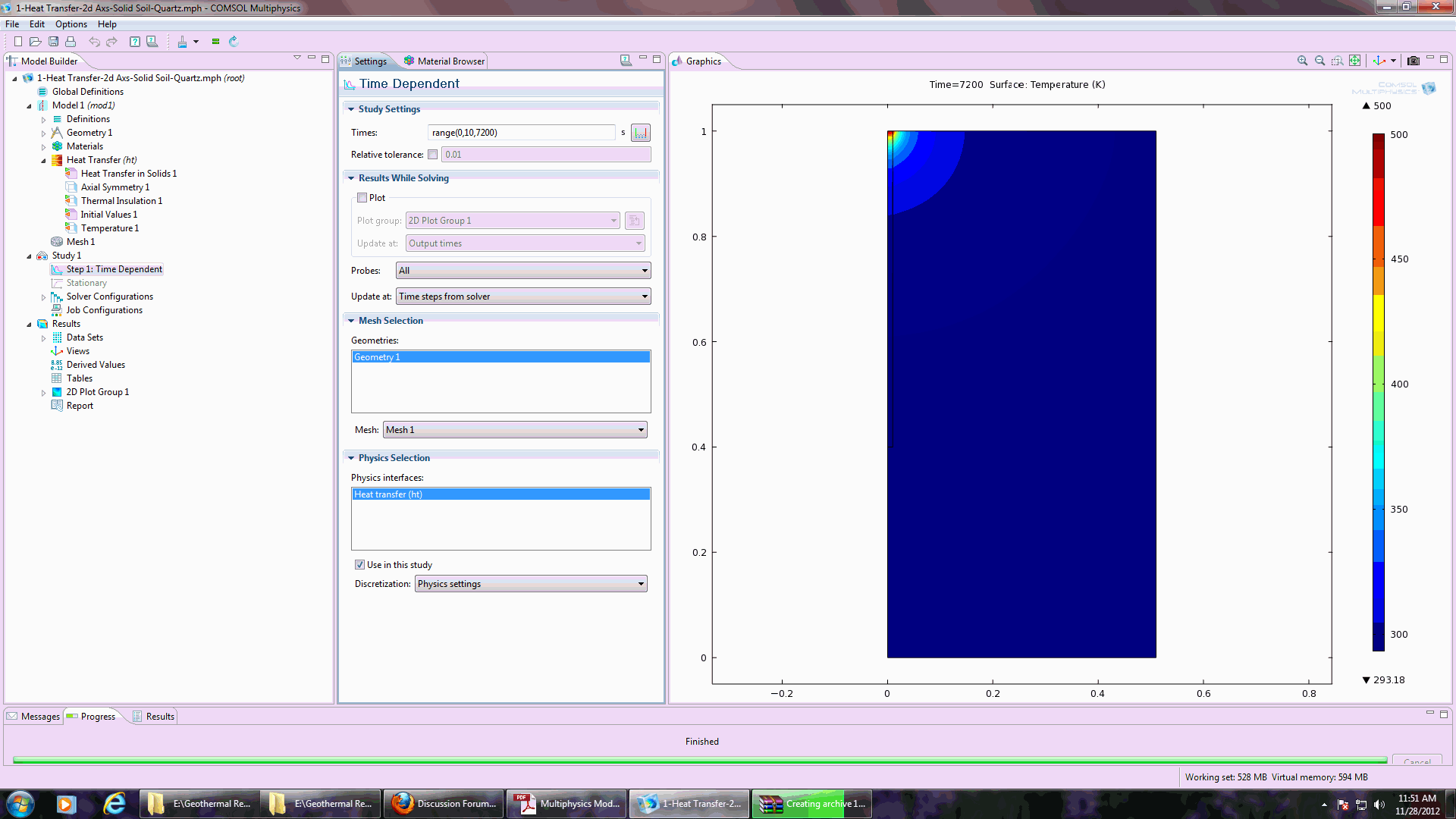

I am a comsol user and I want to have a 2d axisymmetric model. In my model, I have a soil sample that I put a steel bar in the soil. I want to heat the steel bar with a constant temperature 500(k) and then wait for 6 hours to see that how the heat will be conducted in the soil. The problem that I have is that after simulation, I do not know why I could not have good results. The heat will just be conducted at the top of the model, and the rest of the model will remain unaffected. You can see my model in attached file.So if it possible, I want to know that what do I need to do to solve this problem? Where is my mistake?

Based on the figure you attached it seems that you are only applying the 500K temperature at the top surface and not along the full bar.
Nagi Elabbasi
Veryst Engineering
Based on the figure you attached it seems that you are only applying the 500K temperature at the top surface and not along the full bar. Nagi Elabbasi Veryst Engineering

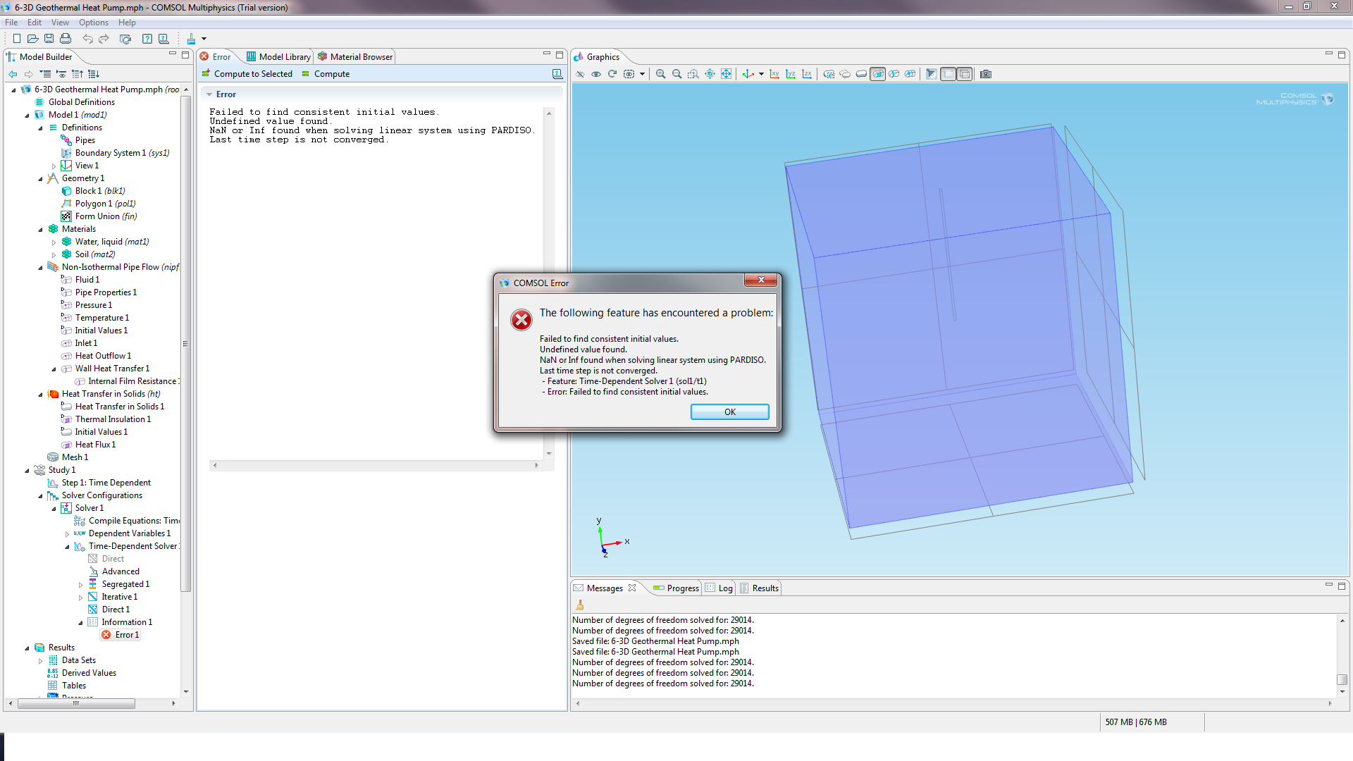

Dear Nagi;
First I have to appreciate you because of your kind consideration.I have another problem. I am modeling a pipe in the soil in 3d. When I want to solve the problem, I will see this error:
Failed to find consistent initial values.
Undefined value found.
NaN or Inf found when solving linear system using PARDISO.
Last time step is not converged.
What is my mistake?

Dear Nagi; First I have to appreciate you because of your kind consideration.I have another problem. I am modeling a pipe in the soil in 3d. When I want to solve the problem, I will see this error: Failed to find consistent initial values. Undefined value found. NaN or Inf found when solving linear system using PARDISO. Last time step is not converged. What is my mistake? In attached you can see the picture of model an error. Best Regards, Al
Posted: 1 decade ago 2012年12月5日 GMT+1 07:25
often this comes from missing IC or BC values (particularly in multiphysics cases) as you need to be sure that ALL dependent variables have enough BC and coherent IC conditions to give an unique solution to the model.
But you have also sometimes, in time dependent diffusion models, some incoherent IC conditions, typically all default "0" default IC values and then in on place a abrupt temperature change, or velocity change or concentration change. If you do not have a fine enough mesh in this region the solver might crash due to a typical numerical undersampling case.
Often its worth to solve for the initial conditions, and look at the results, see if there are very high gradients, check if one cannot add a little to the BC or IC, or ramp them up with a parametric sweep
Hi often this comes from missing IC or BC values (particularly in multiphysics cases) as you need to be sure that ALL dependent variables have enough BC and coherent IC conditions to give an unique solution to the model. But you have also sometimes, in time dependent diffusion models, some incoherent IC conditions, typically all default "0" default IC values and then in on place a abrupt temperature change, or velocity change or concentration change. If you do not have a fine enough mesh in this region the solver might crash due to a typical numerical undersampling case. Often its worth to solve for the initial conditions, and look at the results, see if there are very high gradients, check if one cannot add a little to the BC or IC, or ramp them up with a parametric sweep -- Good luck Ivar

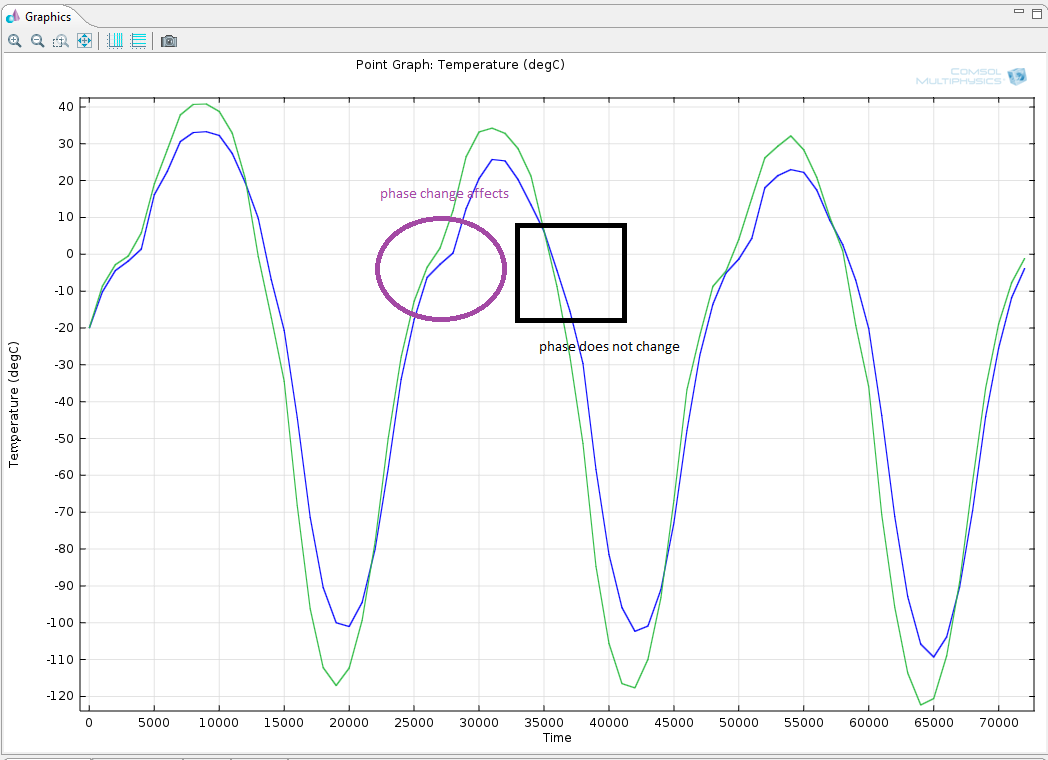

Dear Ivar;
Thank for your kind consideration in advance. I have a probleml. I have a phase change martial and time dependent temperature . the time is SIN formulation. For example for water and ice, the transition temperature is 0 degC. When i heat my model from T=-5 to T=+5, my ice will become water and i can see the phase change procedure. but when my temperature oming from +5 to -5, i do not see the phase change procedure. so what do i have to do? in attached, you can find the picture from results for 2 points in the model.
sincerely yours,
Ali Nasirian
Dear Ivar; Thank for your kind consideration in advance. I have a probleml. I have a phase change martial and time dependent temperature . the time is SIN formulation. For example for water and ice, the transition temperature is 0 degC. When i heat my model from T=-5 to T=+5, my ice will become water and i can see the phase change procedure. but when my temperature oming from +5 to -5, i do not see the phase change procedure. so what do i have to do? in attached, you can find the picture from results for 2 points in the model. sincerely yours, Ali Nasirian
Posted: 1 decade ago 2013年2月23日 GMT+1 15:04
phase change is a delicate physics,as you have large discontinuities due ti the latent heat you need to know locally if you are in one or the other state, and you must know if you go up or down the temperature scale
Now you do not tell us much how you have programmed your phase chage model
Hi phase change is a delicate physics,as you have large discontinuities due ti the latent heat you need to know locally if you are in one or the other state, and you must know if you go up or down the temperature scale Now you do not tell us much how you have programmed your phase chage model -- Good luck Ivar
