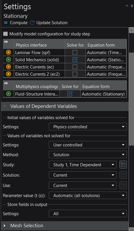

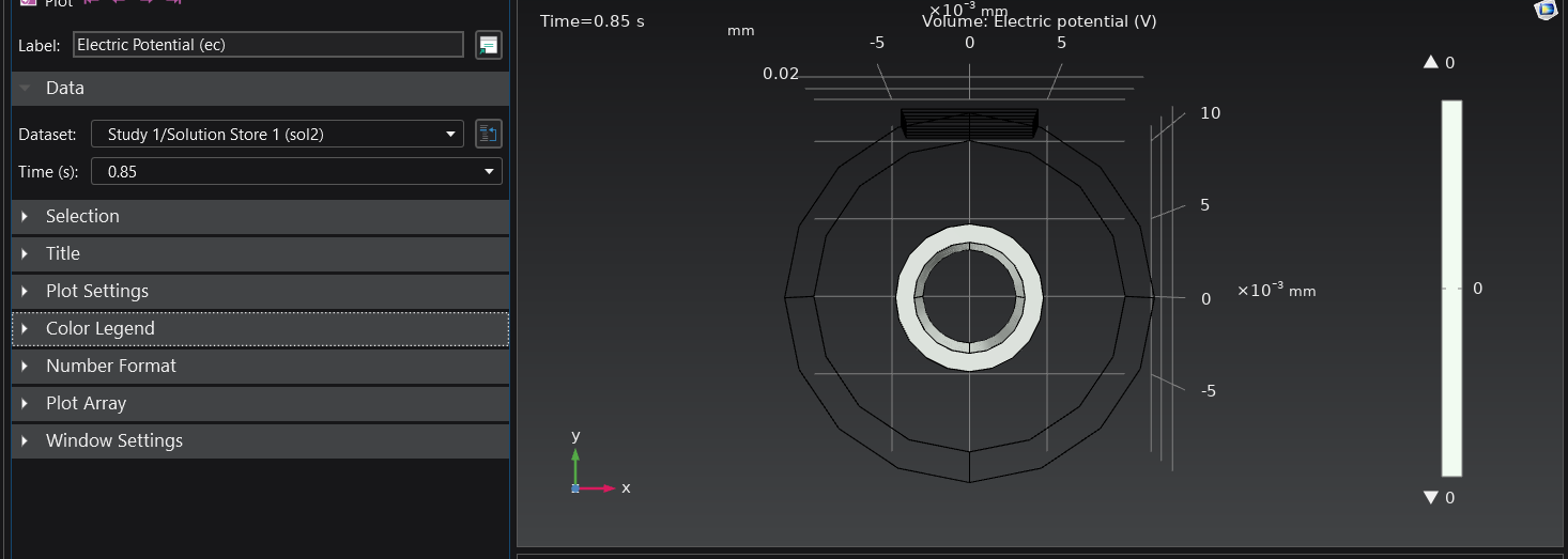

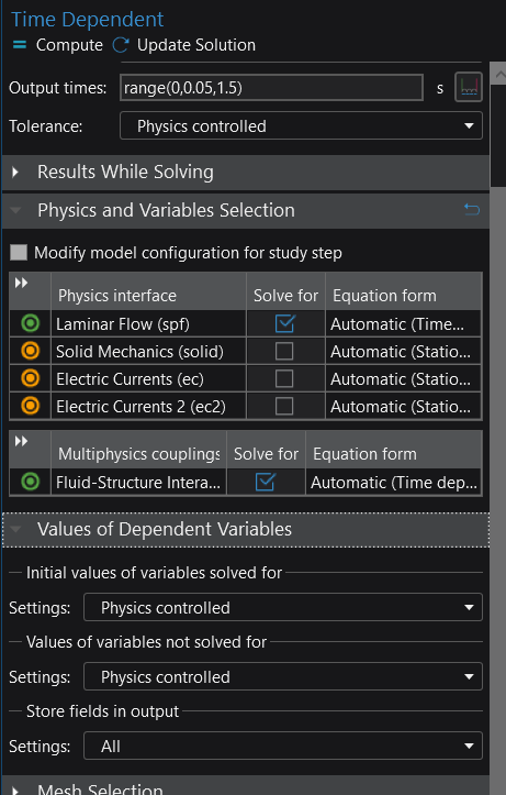

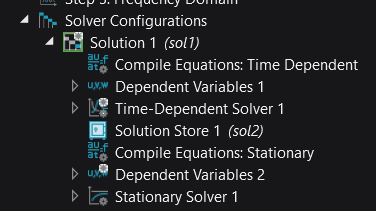

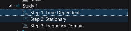

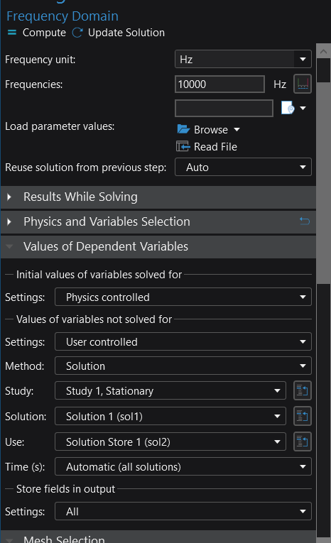

Hi, I am a new to comsol and I have a 3d components that its dimension changes during my solid mechanics simulation and I can have the displacement as my results. I also have an AC current in my simulation which is working fine. the only issue is that I do not know how I can couple them together. for instance, in my time dependent solid mechanics simulation, I have a displacement in the shape of my model, I want to have that AC voltage at the deformed shape at each timestep. right now the issue is that I only have 1 result from my ec simulation and I can't see any of the results over time.
I also atteched the screenshots from my configurations.
