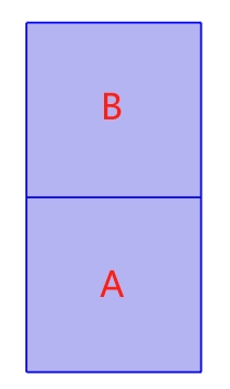

Hi there, I am trying to understand how the cohesive model works in Comsol.
A simple model including square A and B in contact with each other is built. B is assigned as rigid material and pulled along the vector (u,v)=(0.4,0.4), while the top boundary of A, which is in contact with B, is fixed, so that both shear and tension occurs between the contact pair.

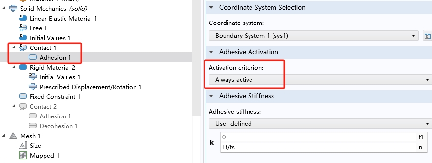

For the contact, the adhesive activation criterion is set to 'Always active'. The adhesive stiffness is set to be 0 for kt1 and Et/ts for kn.There is NO decohesion sub-node.

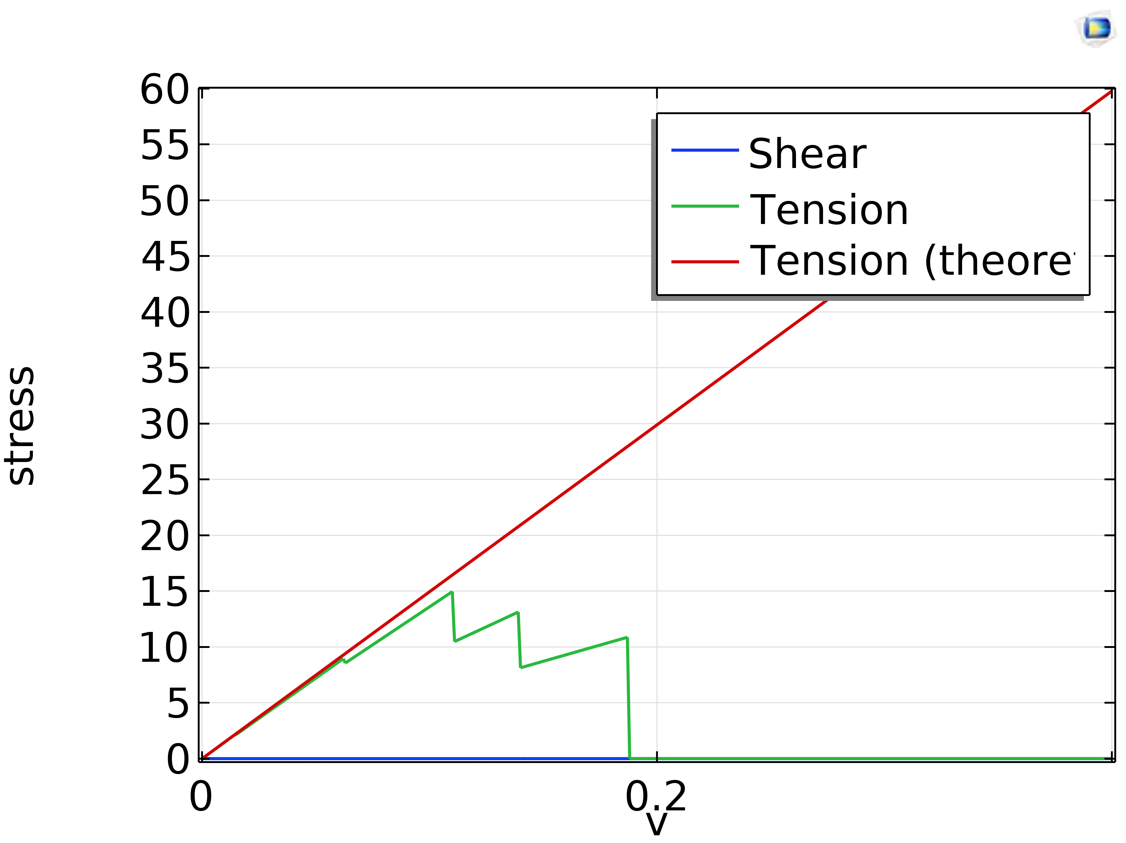

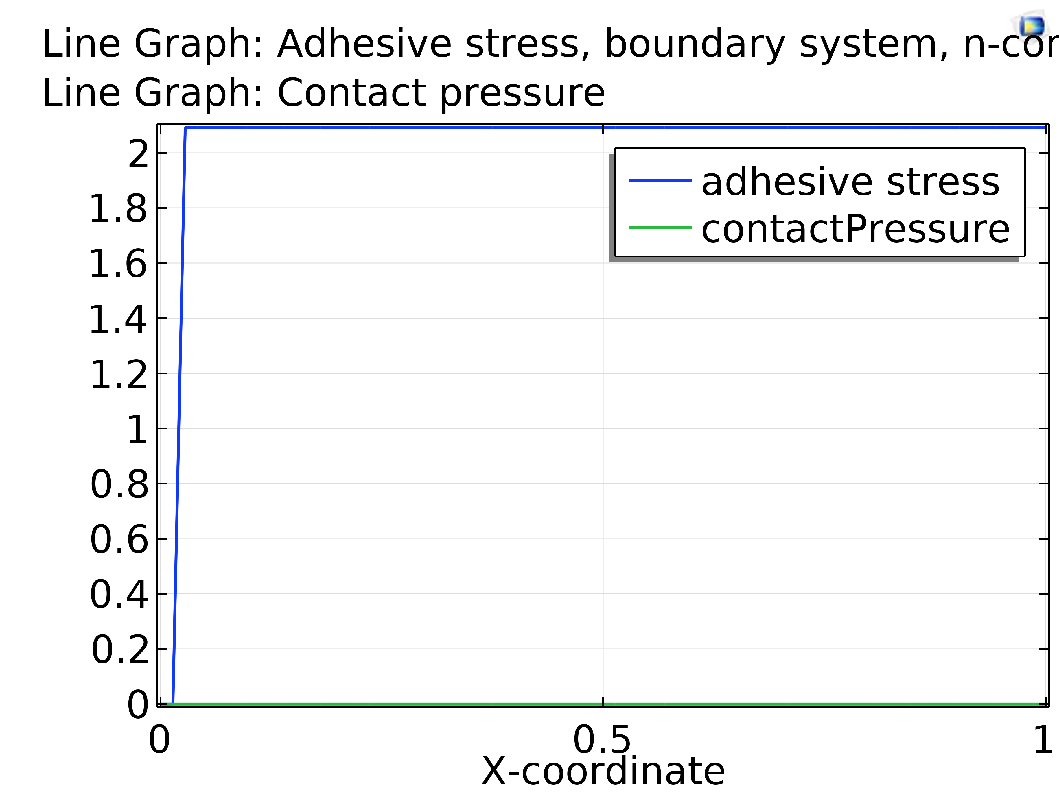

The results are strange. Shear stress remains 0 (blue line), which is consistent with the 0 shear stiffness. But the normal tension stress (green line) doesn't follow the theoretical value (red line), and finally reduces to 0.
It seems that decohesion does happen, though no decohesion law is specified.

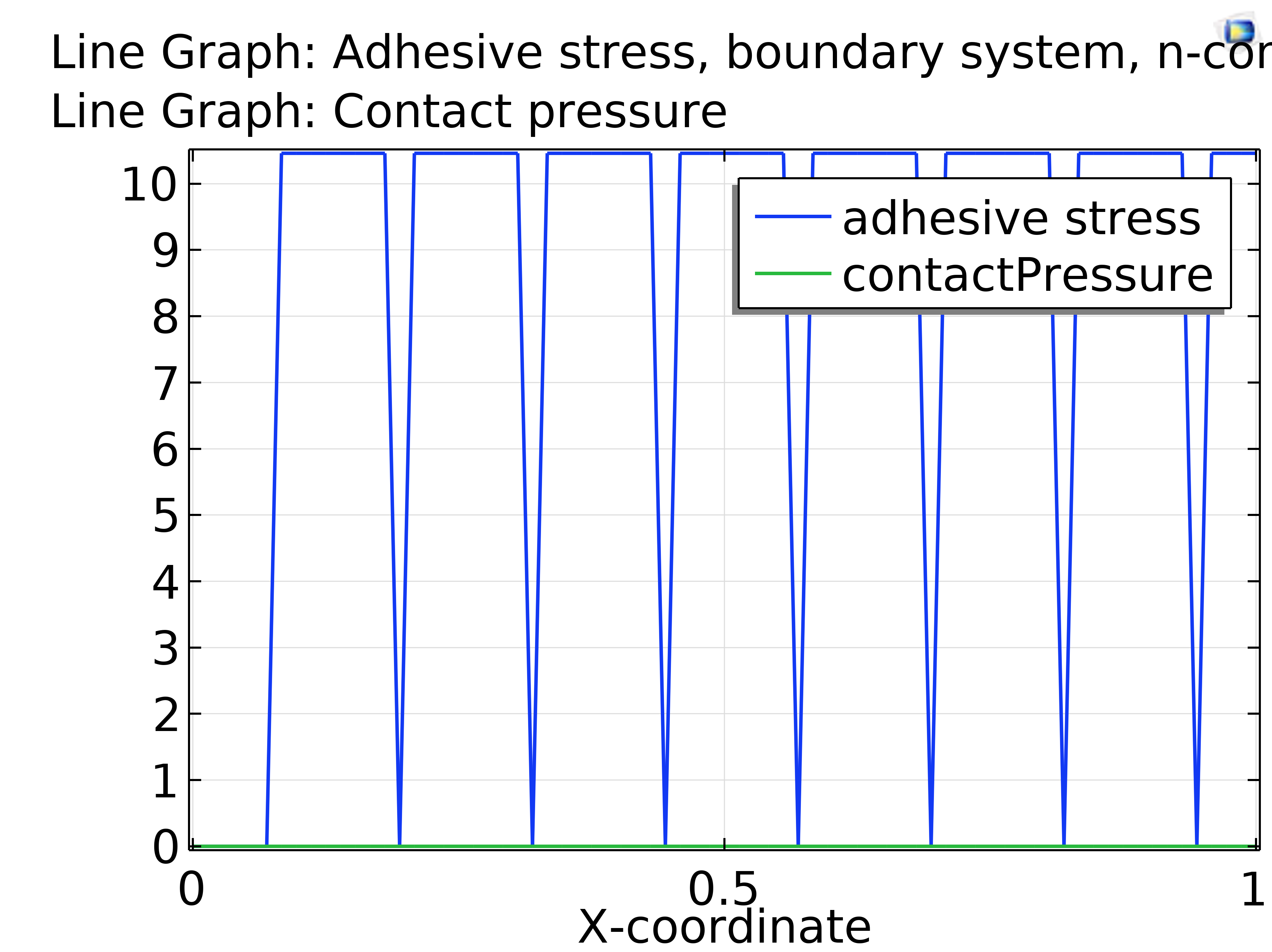

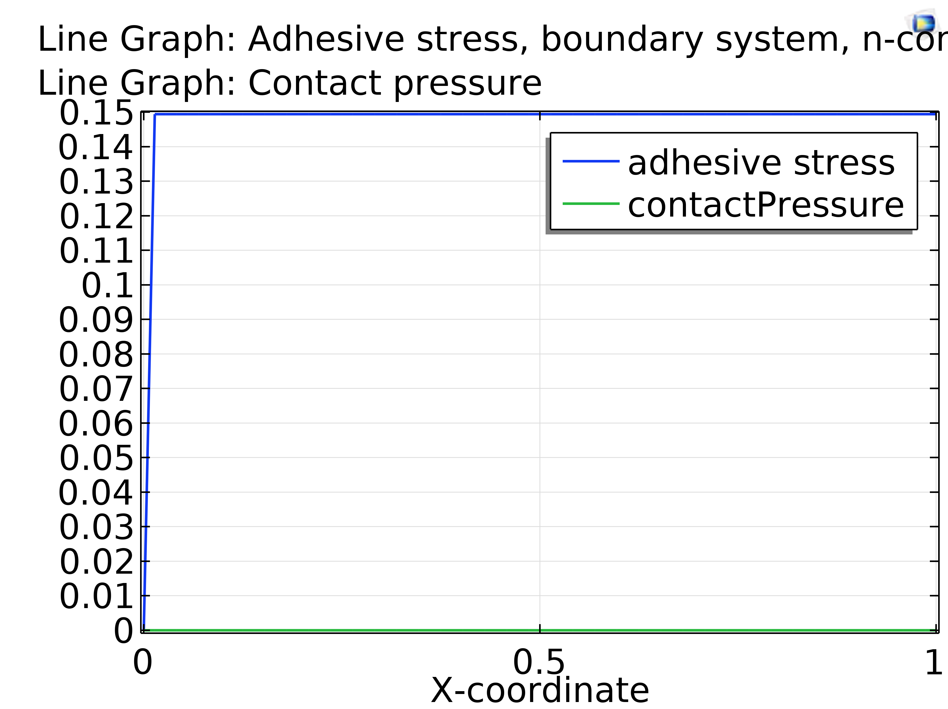

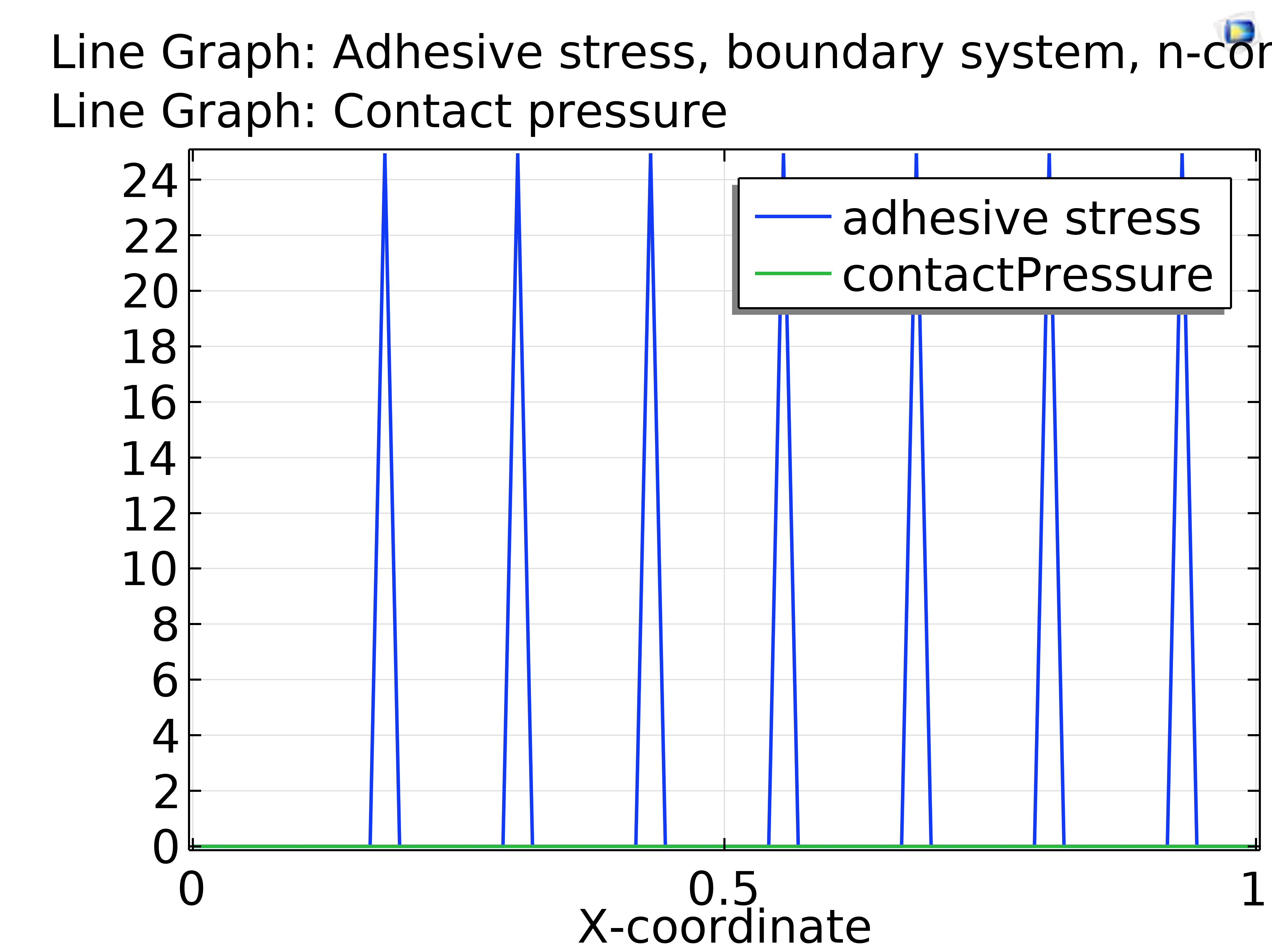

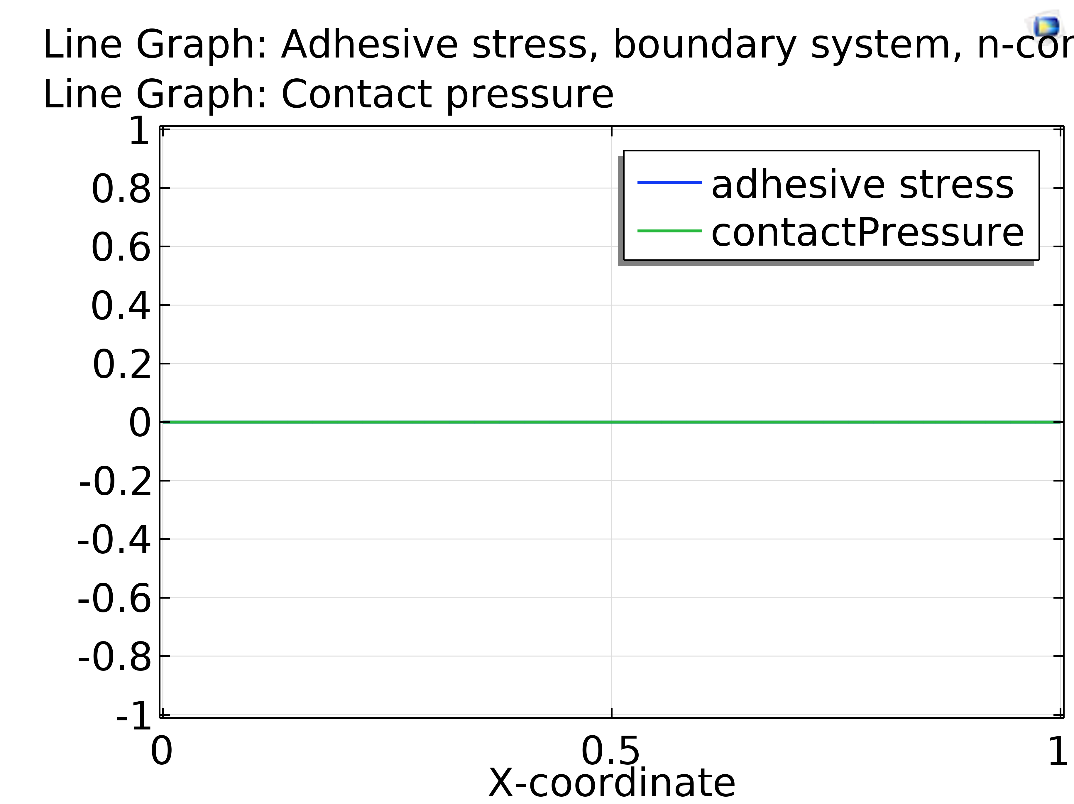

The adhesive stress distribution on the contact boundary is give at v=0.001,0.014,0.070,0.167,0.181, as follows
As shown above, the contact pair is not totally adhesive. There is a decohesion site at x=0 initially. As the load increases, the zone of decohesion expands. And then, much more new decohesion sites emerge and expand progressively. Finlly, the totally decohesion happens.
But the adhesion activation criterion is set to 'Always active' and no decohesion law has been specified yet.
This is disturbing.Is there something that I did not do it right?
