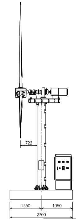

I will also attach a part of the wind turbine's blueprint I am aiming to model, just in case. Thank you again.
