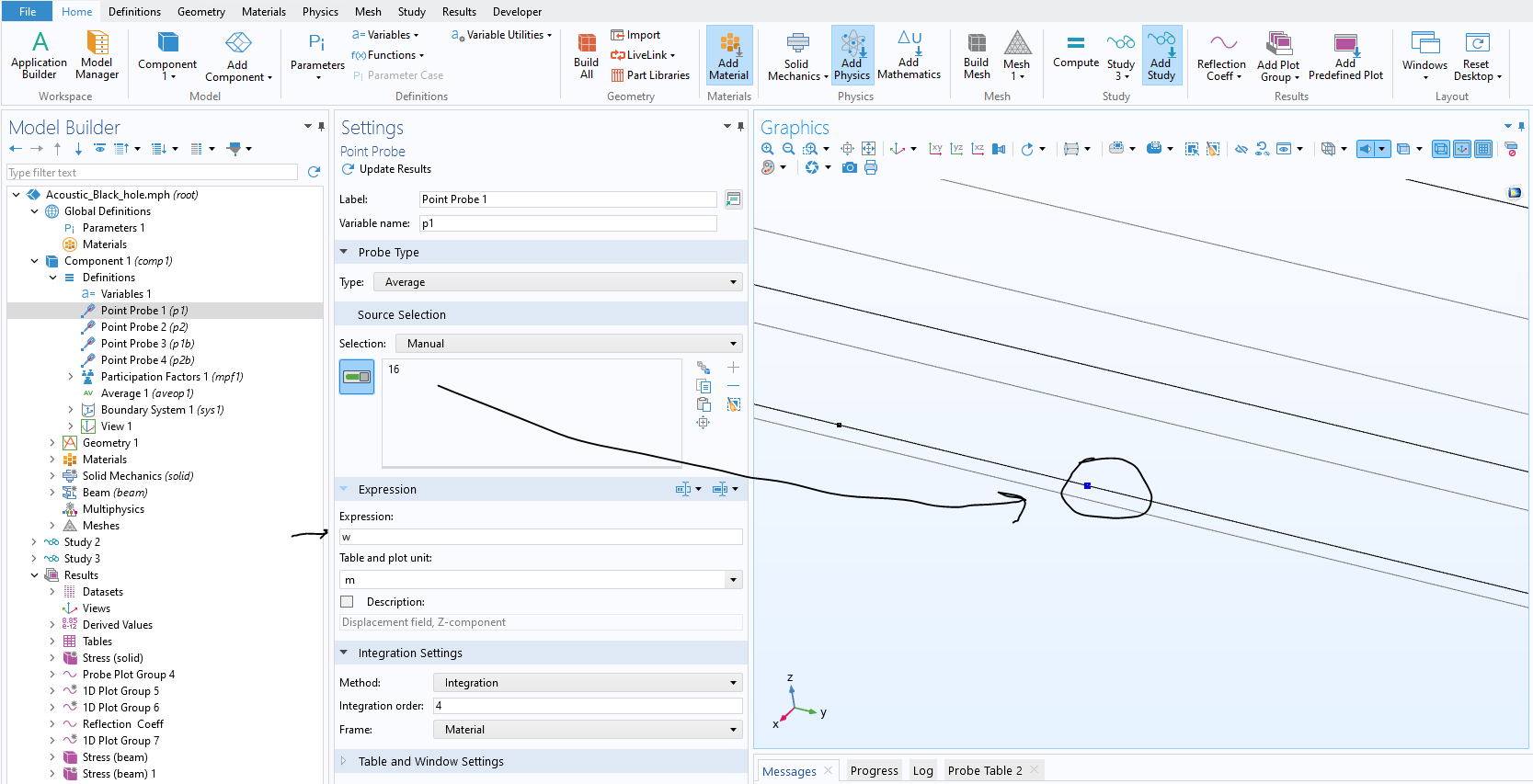

The dispalcement is calculated when solving the study. The point probe stores displacement value at a particular point. For example in the screenshot, point probe 1 is setup to store the z component of displacement at point 16. It is stored to a variable named p1.
