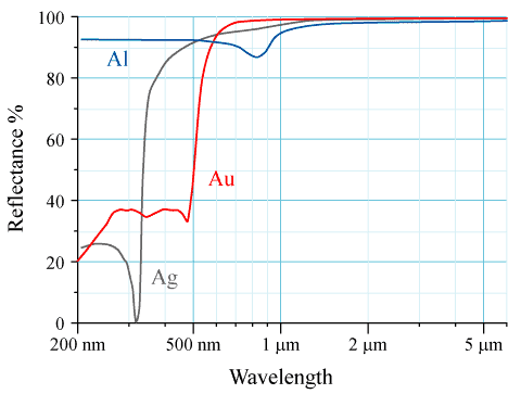

I'm aiming to characterize the reflectance versus wavelength for a glass + silver configuration, with glass as the substrate, similar to the pattern shown in the attached graph (a random Google image). My ultimate objective is to simulate a Passive Daytime Radiative Cooling device (PDRC) comprising layers of Glass, Silver, and PDMS, in that order. I initially used a 350-micron thick silver layer due to uncertainty about the precise thickness of the silver layer. However, the actual thickness of the Silver layer is intended to be 120 nm.
