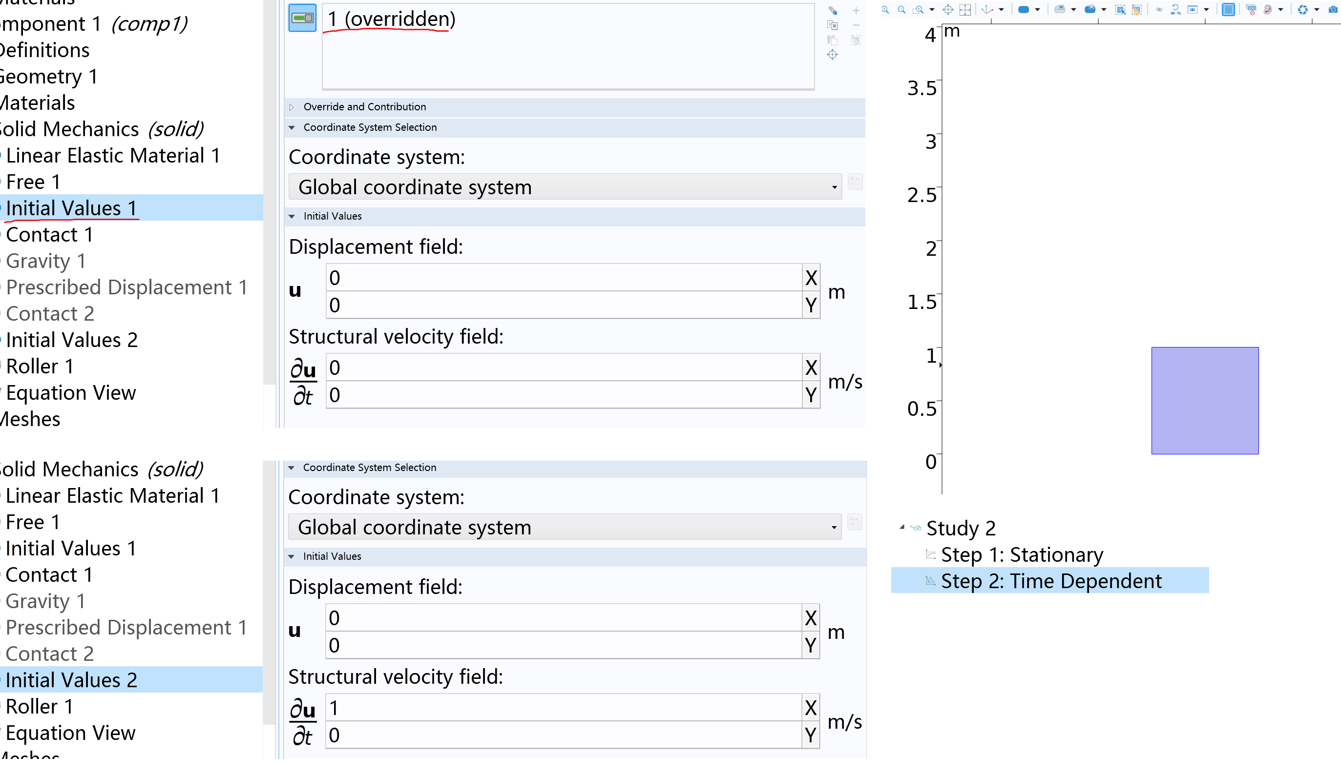

Posted: 3 years ago 2024年4月3日 GMT+8 10:29
Thank you Dr Sönnerlind. I strictly follow your advice (In step 1, disable the second Initial Condition node under Modify model configuration for study step) as in the attached figure. But the block never moves. It seems that the second initial condition isn't applied at all by the software.
Posted: 3 years ago 2024年4月5日 GMT+8 09:26
Will the interface of "values of dependent variables" and " Initial values of variables solved for" be relevant to this question?
Posted: 3 years ago 2024年4月8日 GMT+8 17:29
That is correct. You need to take initial values fromUser Controlled->Initial Expressionin the second study. The default is to use results from the previous study as initial conditions.
Henrik Sönnerlind
COMSOL
That is correct. You need to take initial values from *User Controlled* -> *Initial Expression* in the second study. The default is to use results from the previous study as initial conditions.
