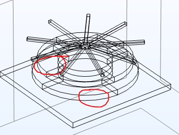

Hello There,
I need a help to change my circular coil to hexagonal shape.Take a look the editing area here,I am adding my design file here.

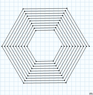

I modified the expressions in the hexagon example. It is not exactly your desired shape, but I hope you get the idea and can modify it to your needs. The parameter wind is the number of windings. Essentially the expression subtracts a smaller hexagon (factor 0.01) whose points are linearly scaled with the parameterization angle in the range vectors. I am not submitting a model file, because your example is version 5.3 and I don't have that installed anymore.
cos({range(0,1.0471975511965976,wind* 2* pi)})-0.01* range(0,1.0471975511965976,wind* 2* pi)* cos({range(0,1.0471975511965976,wind* 2* pi)})
sin({range(0,1.0471975511965976,wind* 2* pi)})-0.01* range(0,1.0471975511965976,wind* 2* pi)* sin({range(0,1.0471975511965976,wind* 2* pi)})
Change the object type from solid to an open curve.
Cheers Edgar

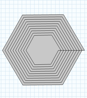

I have included the equation in the simulation and find the hexagonal shape in attached file. But, it looks kind of mismatched with ends.

As I wrote in my first post you must change the object type from solid to open curve.

Yes, I changed to open curve and it works what you have said (see the attachment) The design I showed for hexagonal coil was 2D. But for my design I want to do it in 3D. I saw people use parametric curve in designing circular type helix coil. The equation you have posted works for sure.
