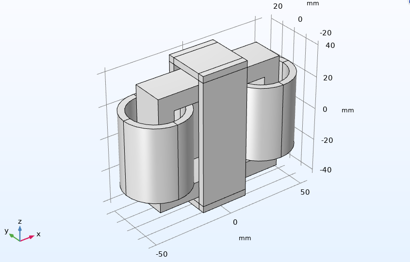

I’m currently working on simulating a magnetometer . I have two coils connected in series with opposite winding directions like(double rod magnetometer). Surprisingly, even in the absence of an external magnetic field, I observe a voltage across the sensing coil.Why do I obtain a voltage across the sensing coil without an external magnetic field?How do I properly introduce the external magnetic field in my simulation? Which boundary conditions should I use?Any guidance or insights would be greatly appreciated! Thank you in advance.
