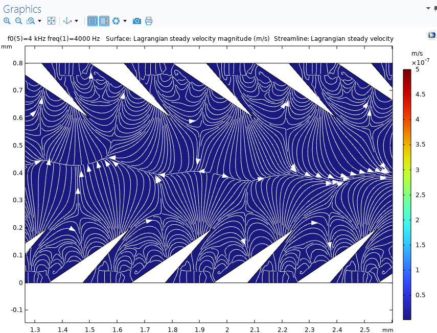

Thanks for the response. That definitely makes sense and seems to be solving as intended now in terms of getting stationary results for each frequency, but I am getting some very weird results that are different to when I solved them in two separate studies. I am unsure if this is due to it solving the physics differently/wrong but it is definitely different to the results I get when solving in separate studies (which agree much more with literature). I have attached the streamline plots underneath. As far as I can tell the study step itself is identical to the one I used when they were separate studies so I'm a bit lost as to why there is such a big change. Thansk again for your help.
