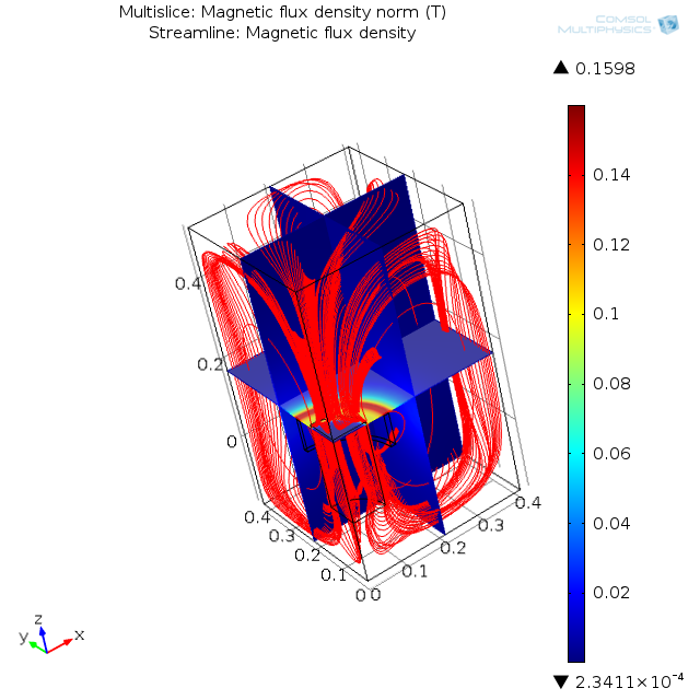

Thank you Ivar for your answer,
In fact I don't understand why I have to add a new Ampères law because in mef there is already by default the Ampères law and current conservation in the first node.
Can you explain to me why I have to add the same equation in a new node?
I try what you say in adding a new Ampères law which overriddes the first on the core domain, it give some crazy results extremely sensitive to the mesh density (I use boundary layers), I think no realistic results.
Thank you

I have tried a new excitation type;
-10 V terminal for mef
-10 V single turn coil domain for mf
It gives me the same results in power dissipation in the core for the 2 physics.
I don't understand what's happens really but it works,
thank you Ivar

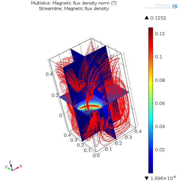

When I add an Ampère law on the gas domain results change
it gives more power dissipated in core with mef, around 50 % more, and about the same power dissipated in the coil
Thank you again
