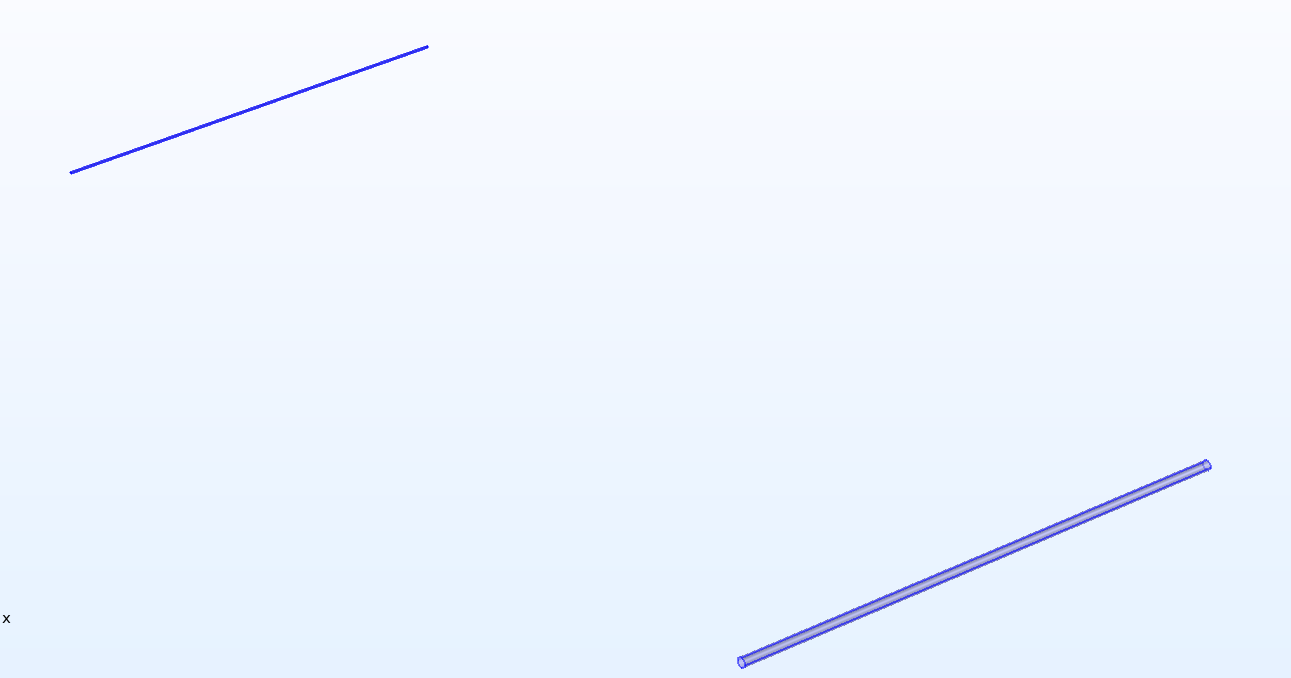

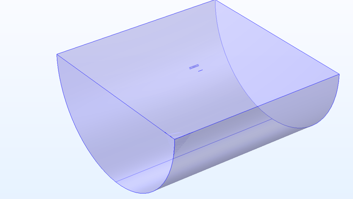

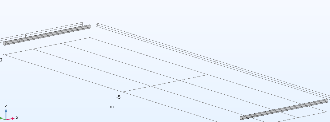

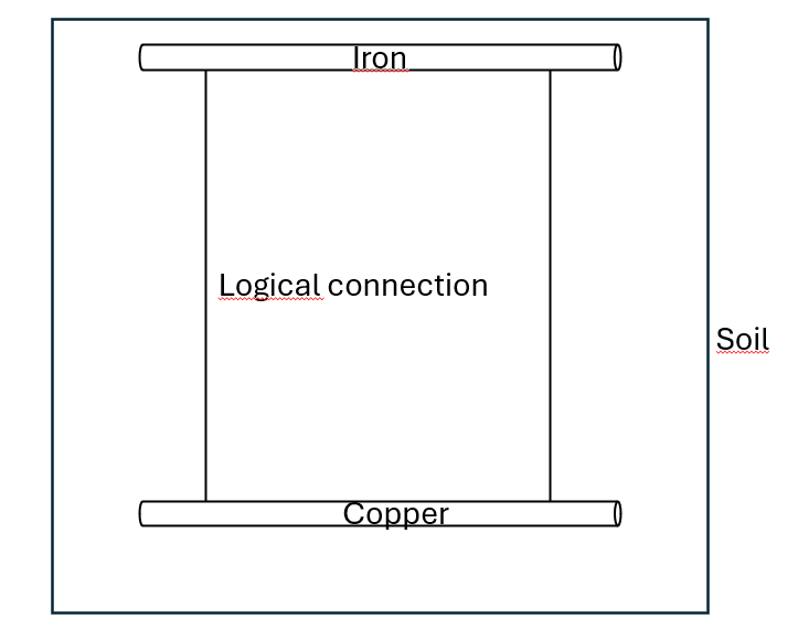

My purpose is to create logical connections between these two materials, and I want these connections to be logical, without adding another physical element in the ground, I mean these connection as if they were isolated conductors that do not interfere with the surrounding environment. In the image, I have identified the boundaries that are relevant for the connections between the two materials. I don't want to impose scalar boundaries because I'd like the software to adapt the solution. Therefore, I have created two identity pairs, applying a floating potential condition to each of them. I don't know if it's the best solution, this is the reason why I am kindly requesting forum assistance.

I am still not sure what you are trying to do although I suspect you are making it more complicated than it has to be.
I suggest you post your model (including the geometry). Be sure to include a domain surrounding the conductors (the soil).
And I suggest you describe the problem in terms of voltage sources, current sources, and meters.
I am still not sure what you are trying to do although I suspect you are making it more complicated than it has to be. I suggest you post your model (including the geometry). Be sure to include a domain surrounding the conductors (the soil). And I suggest you describe the problem in terms of voltage sources, current sources, and meters.
