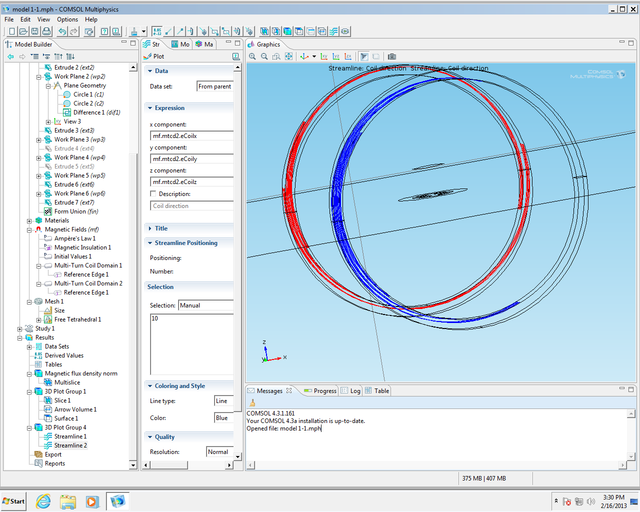

Hey, i am having some problems creating the steamlines for my Helmholtz coil. I followed the steps for the one of the model on comsol website for Helmholtz coil except other than revolve to create the coils i did extrusion instead. Now i am getting something really weird for my streamline and I compared with the Helmholtz coil file i downloaded from the website and i looks like I did the exact same thing with the example. I couldn't figure out what might possibly go wrong. I have attached a picture of the streamline I have now. Can you tell me what I did wrong and help me fix it? Thank you.
18 Replies Last Post 2013年3月10日 GMT+1 03:20
Posted: 1 decade ago 2013年2月16日 GMT+1 22:49
it looks like you used a geometry parameter for the components of the flux lines. You must use the magnetic flux density components instead and assign proper start coordinates.
Cheers
Edgar
Hi, it looks like you used a geometry parameter for the components of the flux lines. You must use the magnetic flux density components instead and assign proper start coordinates. Cheers Edgar

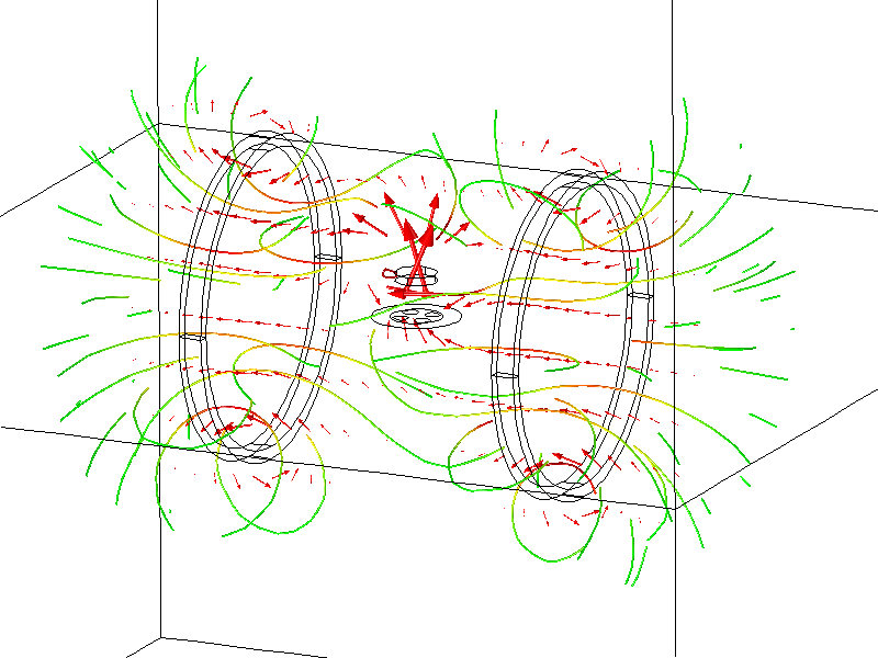

Hello!
I have modified your model; is this what you are looking for?
Ralf
Hello! I have modified your model; is this what you are looking for? Ralf

Hello!
You have to solve it again; the model is clean (deleted mesh and solution to keep the file small).
As Ivar said I use only one MF physic to define all things.
Look at the 3D plotgroup 2 how the definition of streamlines is used (also limits for data range and color...).
Ralf

Hey!
I resolved the model as you said and now I got the graph you did. it look good! thank you!
I still have some questions.
first, I see in this model we only have one mesh which has both the coil and the permanent magnet in between. So is the arrow volume and streamline for magnetische flussdichte has considered the interaction between the coil and the permanent magnet already? it looks like it has because i see the arrow near the permanent magnet is so much bigger than the other ones. Just want to make sure;

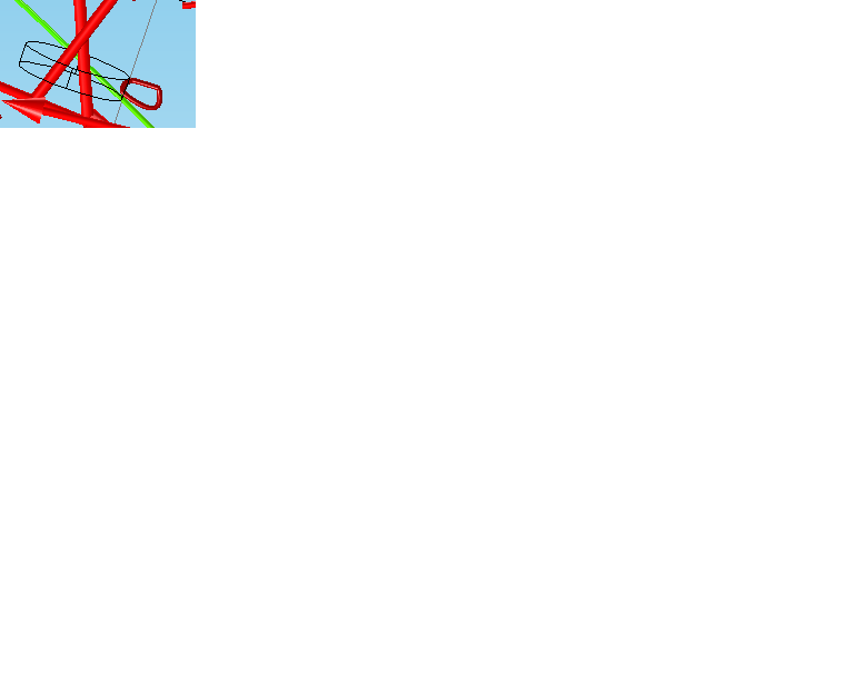

and also, what is the little circular thing attach to the cylinder in the middle? (i have attached a screen shot of it)

Hello!
Yes, the solution is for all parts; they produce one mag. field.
The little ring is one streamline. Since you have a strong magnet and a little coil current, the field from the magnet is much stronger. My streamlines depend on field strength...
If you increase the currents from 5 to 50A, you will see better images. Play with streamline parameters - you have several options!
The arrows will show you the orientation of the magnet. If you reverse the magnetization, the arrows near the magnet will also be reversed.
It would be better, to use a finer mesh...
Ralf

Hey!
The arrow for the orientation of the permanent magnet, can you be more specific? are you talking about the red ones in the field or the one I have attached on my previous reply? Btw, what is the little red thing attached at the side of the permanent magnet?
