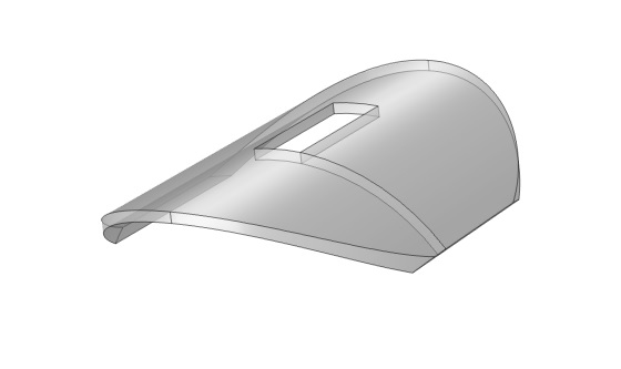

I am currently working on designing a coil in COMSOL Multiphysics and would appreciate some guidance on how to proceed. My goal is to model a coil and simulate its electromagnetic behavior, but I am unsure about the steps involved in setting up the physics correctly. my coil design is so complicated for me. i upload image of my coil for you in real i have this coil.
-What is the best way to design the coil geometry? Should I use a 2D or 3D model, and are there any specific tools or features in COMSOL that can help with this?
-Which physics interfaces should I use for simulating the electromagnetic fields generated by the coil? Should I use the Magnetic Fields (mf) interface, Magnetic and Electric Fields (mef), or another option?
-What boundary conditions are typically applied to such problems?
If anyone has experience with similar simulations or could point me to relevant tutorials, documentation, or example models, I would greatly appreciate it.

thanks i look to some of them before but i think my coil structure is a bit more complex than the tutorials. it's bend over and have a rectangle shape hole. i need an idea to design it or someone who can give me an insight to define me physic better.

Well, you won't find exactly your coil anywhere. Robert's hints should provide information to start something. In case of problems you can get back to the forum, preferably with a model. Images are not very useful in most cases.

thanks for your reply. I uploaded a 3D model of my coil name as "untittled.jpg" before. this coil putted on a pipe . i need to study the megnetic field of this type of coil. i tried to design it easier by design a HelmHoltz coil(simple circular coil) and then use "scale" in "tranforms" to shape it like an oval but i don't know how to bend my design. i thought becuase my coil has more than 750 round of wire it's better to design a 3D model of it not a actual coil it's my fist time that i useCOMSOLso i come here to ask help from experts
