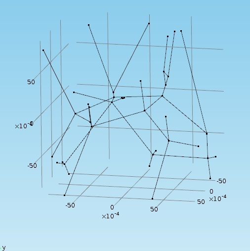

I need to have a simulation of electrical potential in 1D beam elements in a structure. I want to give potential to one point of the model and ground to another point and observe the current flow inside the beam. in fact I need to calculate the whole electrical resistance inthe structure.
when I use Electrical Current in AC/DC module, it tells me that it is not applicable to select a point as a "point electric potential" or "point ground".
I have attached a picture of a sample structure.
How can I do this. should I use another module?
Thanks in advance
Ehsan

actually the structure will go undet tension and I want to see the electrical resistance change during the tensile loading. thats the reason to do it in comsol.
two side of the structure are connected to a power supply and by loading the current changes in each section.
the structure is not made of wires, it is a cellular material so based on their diameter they have a specific resistance.

do you mean using 3d elements? or I got it wrong.
I have touse 1D element(so just lines) because the model is huge and it will be very expensive to model it in 3D.
to use terminals as you said I have to use AC/DC lectrical circuit module?(I'm beginner in COMSOL, specially for electrical simulations)

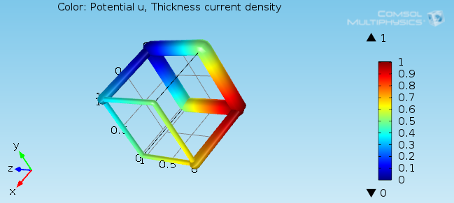

as there is hardly anything that can't be done in COMSOL there is also a solution for edge currents in 3D.
You can very easily use the coefficient form on edges to model that. The attached model shows a wire cube
(the kind that electrical engineering students at my study time needed to solder in their base practicals).
Two corners are connected to ground and a potential. The picture shows the potential and the current density.
For symmetry reasons one branch is completely current free.
If you want to wrap that equation into a physics interface you can also do that using the physics interface builder.
