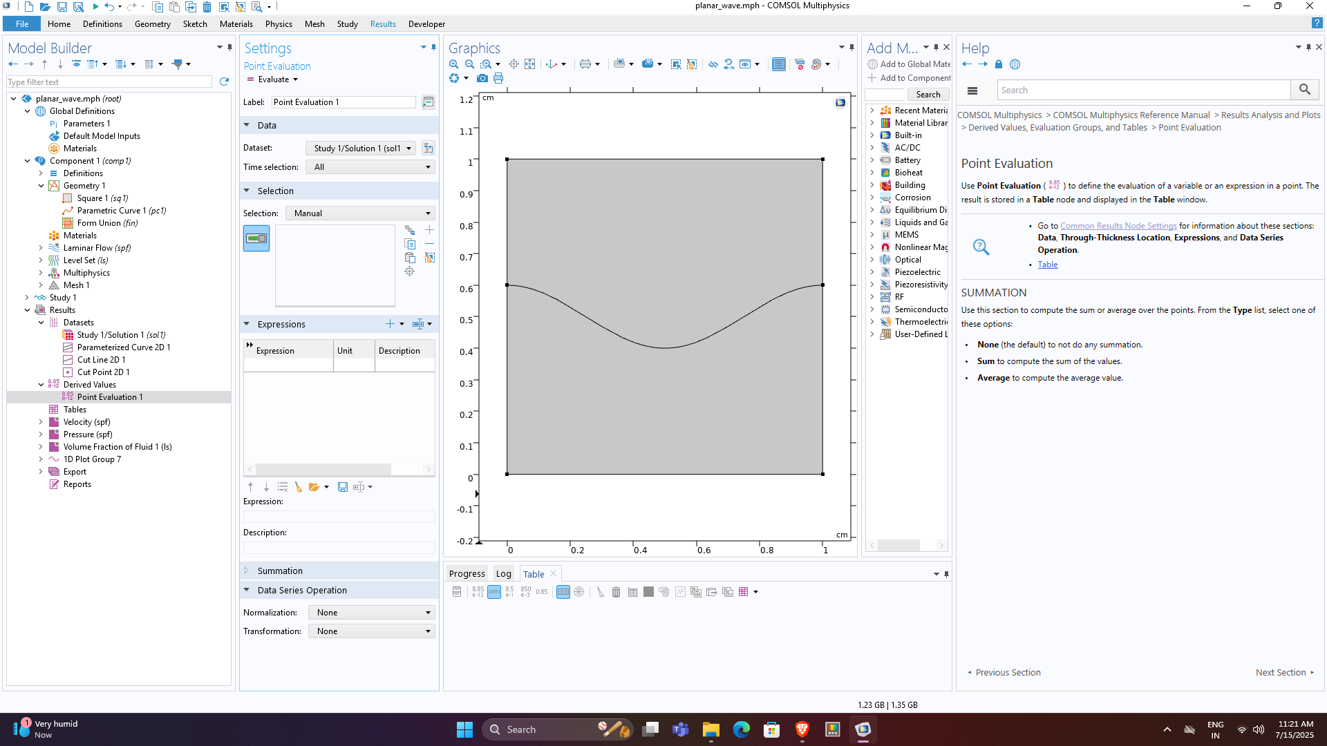

I am trying to replicate the classical test case for capillary waves using COMSOL. I based the idea on the Basilisk CFD simulation, where surface tension acts as the restoring force between two immiscible fluids, creating a standing wave.
My goal is to extract a graph ofamplitude vs timeat the fluid interface. I’ve attempted usingparametric probes,line probes, andcut lines, but haven’t yet achieved the desired result.
Could someone please guide me on how to: 1. Track thewave crest or interface heightover time. 2. Extract and plot arelative amplitude vs timegraph like in classical validation studies (e.g., Prosperetti, Popinet papers)? 3. Usephi(level set function) orVolume Fractiondata effectively for this?
Any help or similar COMSOL examples would be appreciated!
TL;DR: How to extract amplitude vs time data from a capillary wave simulation in COMSOL?
Here is my current setup and results:![https://drive.google.com/file/d/15cP3eWpdQfI2-Tr8aSJL_d_dJZVS8MO8/view?usp=drive_link]
