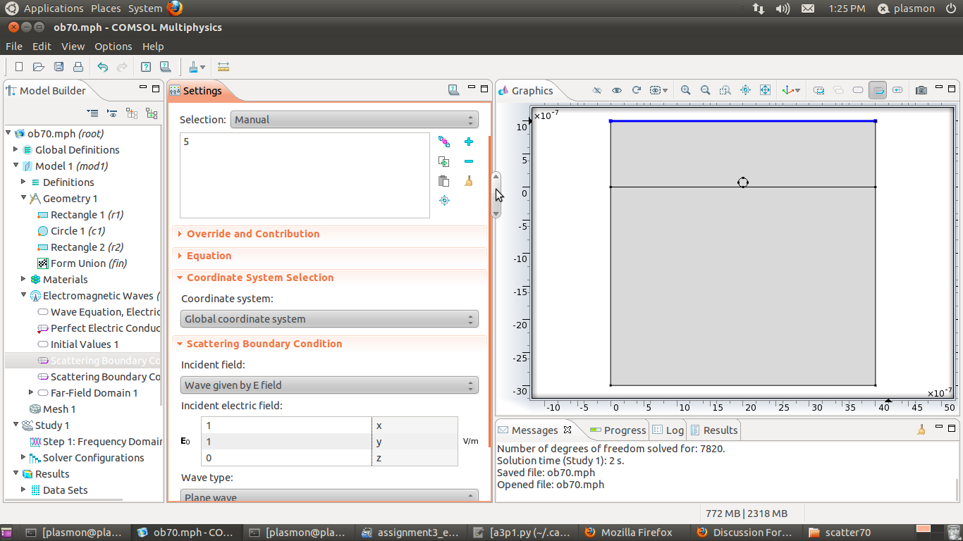

Posted: 1 decade ago 2013年4月1日 GMT+2 08:31
As i have mentioned I am using a 2D model in COMSOL4.2
GEOMETRY AND MATERIALS:
In my simulation domain ,4 micrometer by 4 micrometer,the upper portion is air(4micro*1 micro)and the lower portion is glass.A nanoparticle(say polysterene) of 300 nm is placed at the interface(halfway in my simulation domain).The materials have their usual refractive indices 1,2.37 and 2.51
ELECTROMAGNETIC WAVES:
In the EM WAVE section I have taken the In-plane vector wave(want for TM case) and analyzing the total field(there is option of total field/scattered field).
I am using scattering boundary conditions for my simulation domain boundaries (i don't know if that is correct/if something else might be appropriate)the sc1.png takes into account one scattering boundary and sc2.png takes into account the top boundary condition where light is excited.The farfield settings are shown(there might be some mistake here).(farfield.png)
What i have done is I have taken glass as my FAR FIELD DOMAIN SELECTION and taken the lowest boundary in my boundary selection .
The frequency domain analysis is done and computed.
my wavelength is 632 nm
The plots which i have obtained (HZ and Efarnorm) are the same which i have attached in the previous post.
As i have mentioned I am using a 2D model in COMSOL4.2 GEOMETRY AND MATERIALS: In my simulation domain ,4 micrometer by 4 micrometer,the upper portion is air(4micro*1 micro)and the lower portion is glass.A nanoparticle(say polysterene) of 300 nm is placed at the interface(halfway in my simulation domain).The materials have their usual refractive indices 1,2.37 and 2.51 ELECTROMAGNETIC WAVES: In the EM WAVE section I have taken the In-plane vector wave(want for TM case) and analyzing the total field(there is option of total field/scattered field). I am using scattering boundary conditions for my simulation domain boundaries (i don't know if that is correct/if something else might be appropriate)the sc1.png takes into account one scattering boundary and sc2.png takes into account the top boundary condition where light is excited.The farfield settings are shown(there might be some mistake here).(farfield.png) What i have done is I have taken glass as my FAR FIELD DOMAIN SELECTION and taken the lowest boundary in my boundary selection . The frequency domain analysis is done and computed. my wavelength is 632 nm The plots which i have obtained (HZ and Efarnorm) are the same which i have attached in the previous post.

Posted: 1 decade ago 2013年4月1日 GMT+2 12:35
I think the far field surface plot doesn't make much sense. You are probably interested in the far field along the bottom or lateral boundaries.
Try a 1D line plot along those boundaries and you will see that it gives reasonable results.
