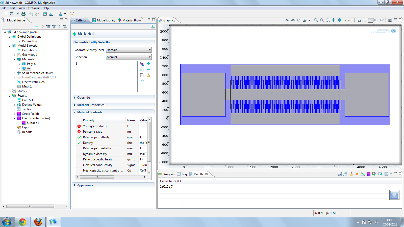

While assigning the material air for domain i am getting the error in material contents for young"s modulus and poisson's ratio i.e it is showing stop signal. please can u explain me this error.
screen shot of the error page has been attached.

Sunil,
Remove air domain from Solid Mechanics node.
Sergei
Sunil, Remove air domain from Solid Mechanics node. Regards, Sergei
