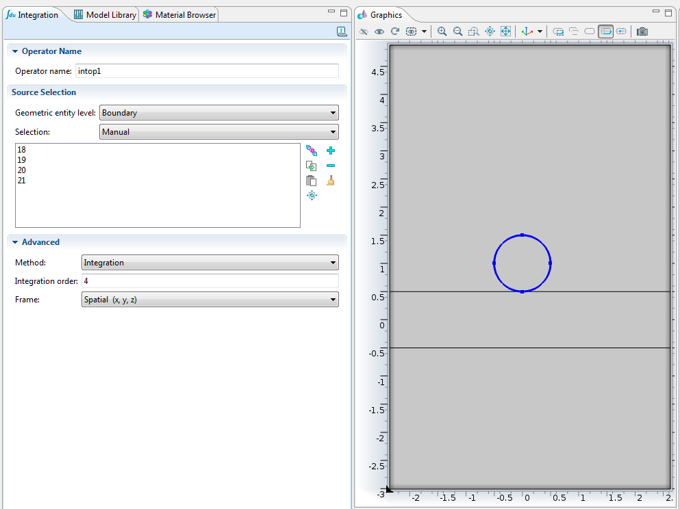

I've attached pictures of my attempt but I don't know how I can get Comsol to do what I want. When I do this I get a value of 2.8*10^-10 N/m
Thanks,
Mark.

Thank you for your reply. I remember reading that Comsol does simulations using a depth of 1m. But for my simulation would it not just assume a circle was projected into a cylinder rather than a sphere? Is this the difference between 2D and 2D axisymmetric?
Either way I cannot reproduce the value obtained by Sergei. I'm concerned with my choice of integration boundaries and if it is possible to do a line integration where the line element is a vector pointing 90 degrees to it's direction as opposed to along the line?
