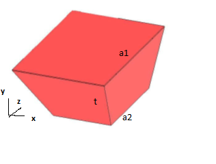

I've been trying to draw the attached truncated pyramid. but really dont know how to .thanks

Posted: 1 decade ago 2013年4月5日 GMT+2 16:33
sorry!! edited with attached picture
Posted: 1 decade ago 2013年4月5日 GMT+2 18:40
Under Geometry > More Primitives > you find Pyramid. It can exactly generate what you want.
Cheers
Edgar
