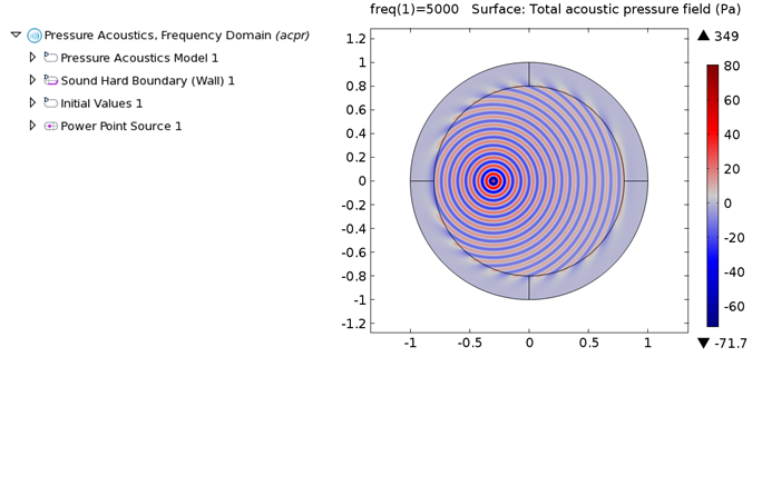

Tran,
To insert acoustic point source, right-click Pressure-Acoustics, Frequency Domain node and select Points>Power Point Source. You can specify point source by power, flow rate, or intensity.
Sergei
Tran, To insert acoustic point source, right-click Pressure-Acoustics, Frequency Domain node and select Points>Power Point Source. You can specify point source by power, flow rate, or intensity. Regards, Sergei

I have a question. What if the acoustic point source is radiating a mixture of frequencies. Let the two predominant Fourier components of the frequency spectrum be F1 and F2. How would you model this case?
Your help will be much appreciated.
Thanks!
