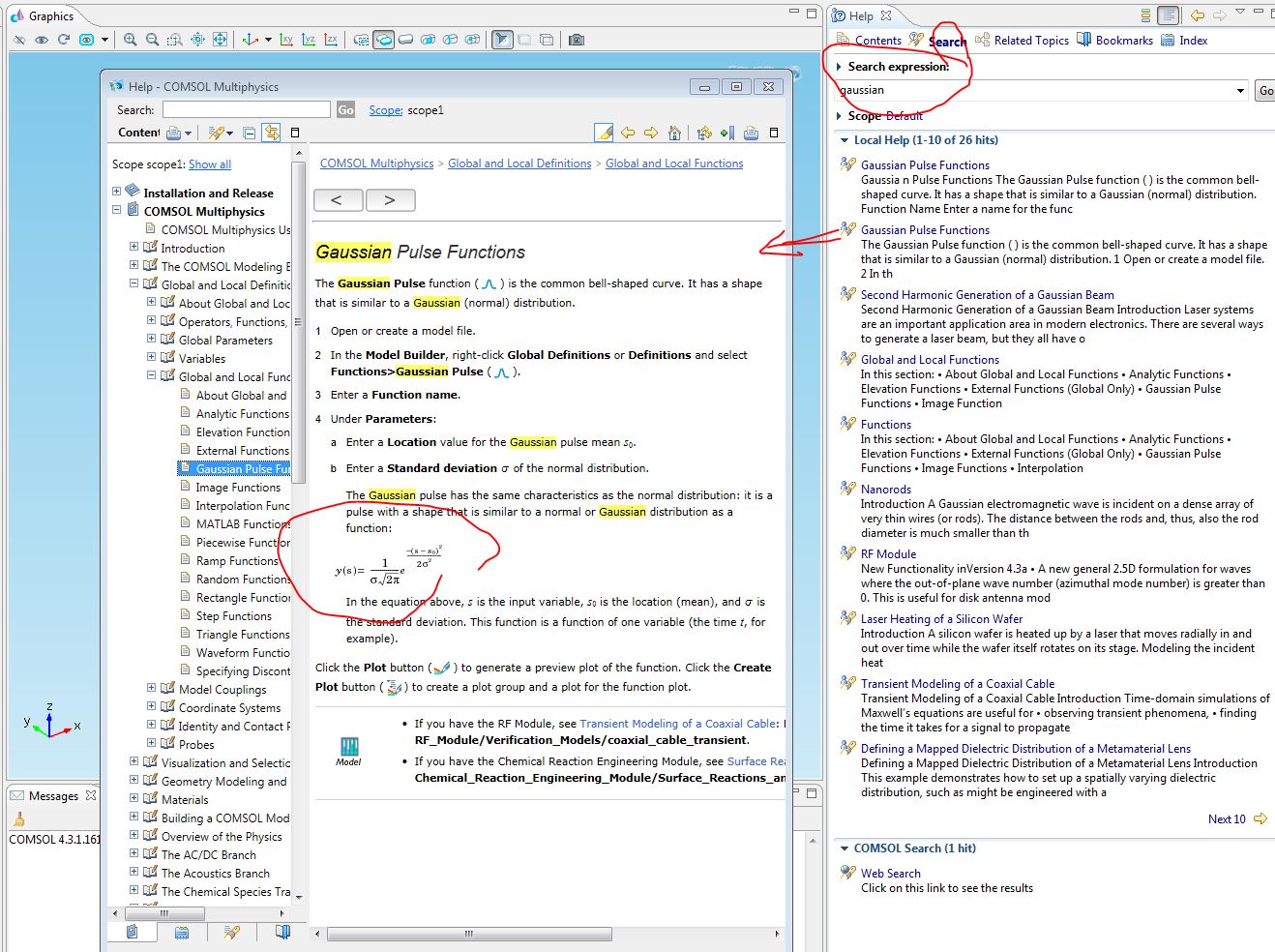

Posted: 1 decade ago 2013年5月3日 GMT+2 17:04
looks like this ;)
v4.3a.161
Hi looks like this ;) v4.3a.161 -- Good luck Ivar
Posted: 1 decade ago 2013年5月13日 GMT+2 13:58
Thank you for your screen but i think that i read this page like 20 times and nevertheless i'm not getting any wiser, that's the analytical expression of the gaussian and not the way i should write it (normalisation) on Comsol but nevermind thank you for your time and your help, I hope I'll have my enlightenment moment.
Cordially
Hi, Thank you for your screen but i think that i read this page like 20 times and nevertheless i'm not getting any wiser, that's the analytical expression of the gaussian and not the way i should write it (normalisation) on Comsol but nevermind thank you for your time and your help, I hope I'll have my enlightenment moment. Cordially
