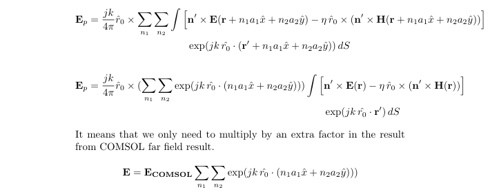

Hi guys. Now I am facing a problem of getting far field from an array. When calculating the near field, periodic condition is applied and only a single unit is calculated. But when I tried to apply far field node in the model, I think COMSOL only do stratton-chu equation on the single unit but not the whole array. Since I want to calculate the far field from the whole array, I think I need the integral on the whole surface of the whole array. Is there a solution for this problem now? Thanks!
I recommend you study the example model: "microstrip_patch_antenna_periodic" in the Comsol-supplied Application Library. "Modeling of a Phased Array Antenna" Application ID: 88011 . See https://www.comsol.com/model/modeling-of-a-phased-array-antenna-88011 . Be sure to read the discussion of how the far field computations are done in the associated .pdf file. You need to apply an array factor.
Yes! From the math structure of Stratton-Chu, I also found that a phase factor is necessary to solve it but my mates not always agree with me. Your advise is really helpful for my work. I will look at it to if there is a difference between my factor and that factor. Thank you again.

I want to know the factor af3() could be. I think it should be a complex number. But from the document, it seems a real number. Is there a source of the array factor?
I get it. They are totally the same.

So if I want to apply this factor and calculate far field in Electromagnetic Waves, Transient. I think I need to multiply this factor in different frequency in far field node in Electromagnetic Waves, Transient. How can I achieve this?

Thanks for your reply! My idea is doing FFT - far field in frequency domain- doing IFFT. But I find their is already a Far-Field node in EW, Transient. Now I'm try to perform the convolution of FFT(array factor) in the time domain but I don't know if it works. I'm totally a green hand with COMSOL and I would be very grateful if you could offer an easy-going literature on transient.
I haven't tried that approach. I suggest you ask Comsol Support for specific suggestions about the best way to do this, especially in regard to including the array factor and/or any kind of periodic (or Floquet) boundary conditions. And before even attempting that, I would want to make sure a single element antenna was being handled properly. Take it one step at a time. https://www.comsol.com/support
Thanks for your advise!
I think of my models again. My model don't need to take array effect into account, so I can just apply far field node in EW, Transient. The other model only need to see the far field spectra in normal direction where array factor equals to 0 for all frequency, so far field of single unit is same as far field of array. I can still just apply far field node in EW, Transient there to get the far field spectra of array in normal direction.
