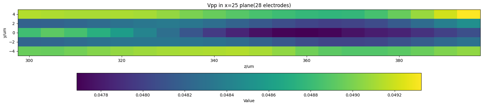

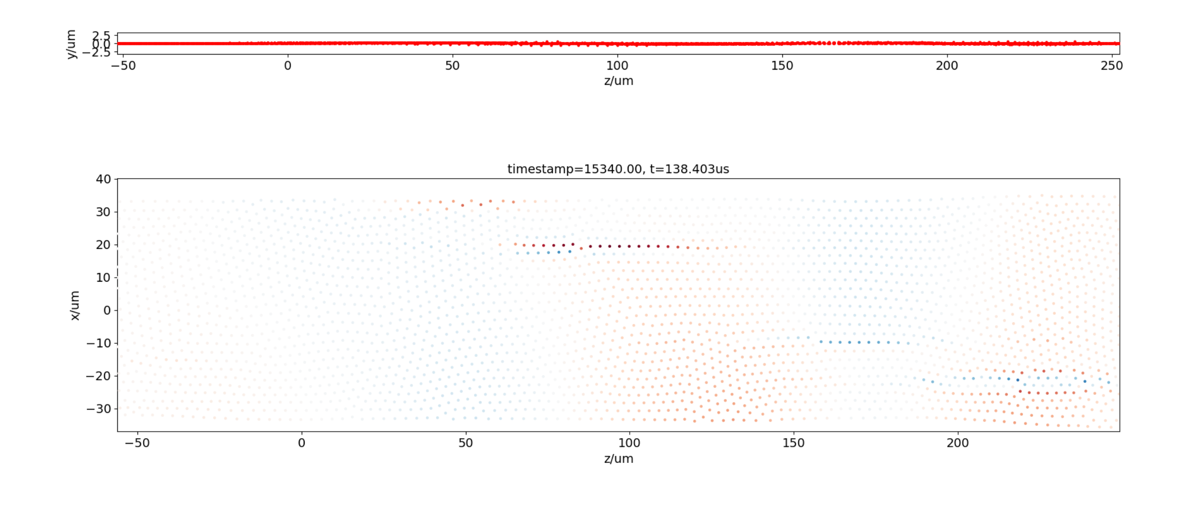

I'm trying to use BEM to calculate the Spatial electric potential field distribution of specific electrodes design, and applied that to trap some charged particles. However, I found that there seems to be some defects of the field that results in extension of the particle arrays in z-direction, which is not physical. And these defects will appear at specific sites, so I suppose it's caused by the defects of field calculation by Comsol. I used user-specified grid, and the grid looks regular, and I calculated the spatial potential distribution, found that there is a 0.001V error for symmetric positions. Are there any solutions to this problem? Thank you!
