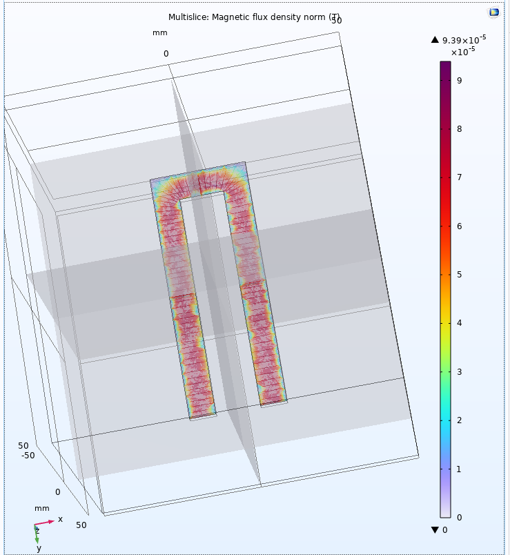

Below is the attached file.
Also can you tell in union i am not able to select the output terminal of my coil. Thanks
Below is the attached file. Also can you tell in union i am not able to select the output terminal of my coil. Thanks

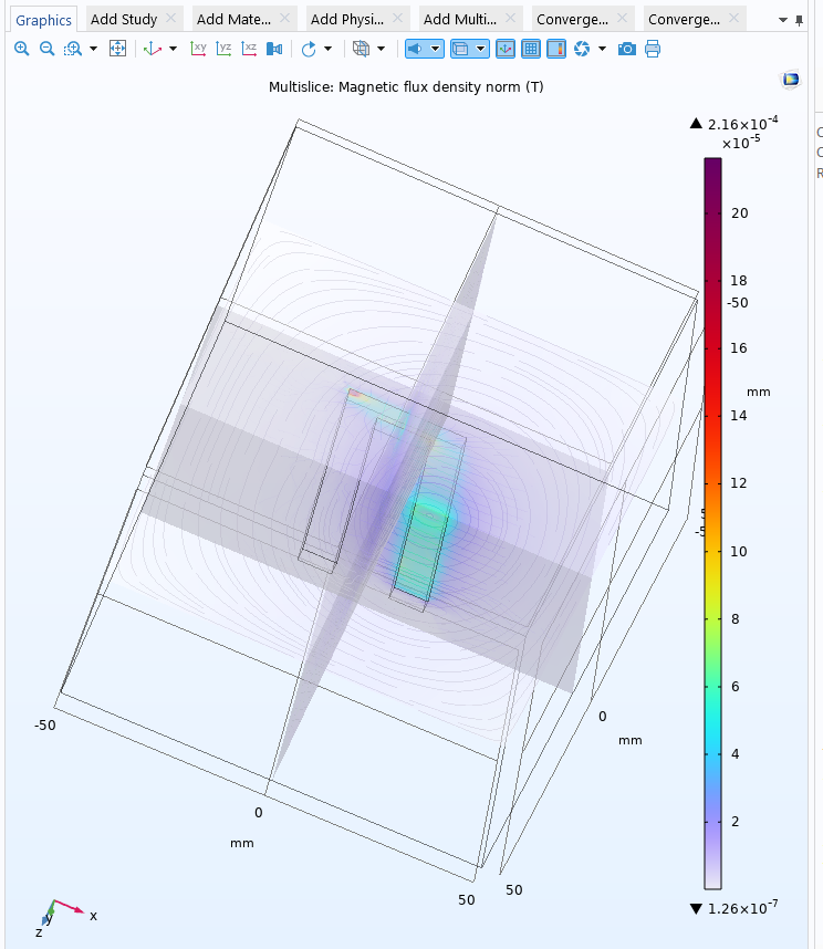

- Your model has a "union" in it but you are actually applying "Form Assembly" anyway. You should have "Form Union" at the end of the geometry section. (See my note 3 below for more.)
- You have a U-shaped conductor that you are attempting to apply a current in to and out of that is an otherwise-isolated open-conducting path in free space! This isunphysical. If it solves at all, it will be difficult (for me, anyway) to properly understand the results obtained as representative of a physical reality. For what it is worth, I have shifted your cube over so that the current input/output connections are on one of the faces of the cube. Whether this represents the physics of your problem or not, I don't know, but at least it is a physically meaningful boundary condition.
- You have magnetic insulation boundary conditions on your conductor. That is unphysical also. Note: If you right-click on "Form Assembly" in the Model Builder and then go to the Settings panel, you can change the Action (under "Form Union/Assembly") to "Form Union." This change will eliminate the incorrect magnetic insulation boundary conditions that the code applied to your conductor when you used "Form Assembly." Note: You shouldalwayscheck that your boundary conditions represent physically meaningful/correct conditions, or else your results (if any) will be wrong.
- There is a 1mm edge block (your "Block 2") in the middle of your model that seems to have no purpose at all. I'm simply ignoring it, but unless it has a purpose, you should get rid of it.
- I've attached a modified model (I cleared the solution to save space; you will need to execute it to see the results) that both solves and gives a meaningful picture (snapshot attached). But you may need to make additional changes, and possiblysubstantialones, to get it to represent yourreal worldproblem (that is, assuming you are trying to model a real-world problem). I hope this helps.
