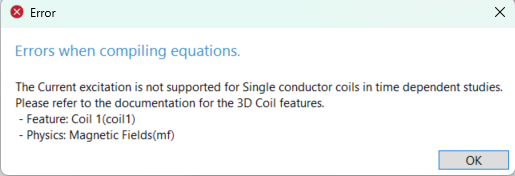

I am working with a planar-type coil modeled as a solid conductor in COMSOL. The coil is excited using a sinusoidal voltage source through an external I–U coupling.
The Coil Geometry Analysis study runs successfully. However, when I attempt to run a Time Dependent study, COMSOL returns the error:
"Current excitation is not supported in single conductor coils in time dependent studies."
To troubleshoot, I also tried removing the external circuit and directly applying a current excitation in the coil, but the same issue persists.

Anushka,
this coil geometry is not well suited for a multiturn coil. The coil geometry analysis has a very hard task to determine the current direction. The current excitation adds extra numerical complexity. Try the single conductor with voltage excitation. If possible make sure the time dependent voltage starts at zero and not at a non-zero value, to make convergence easier at the start of the time dependent step.

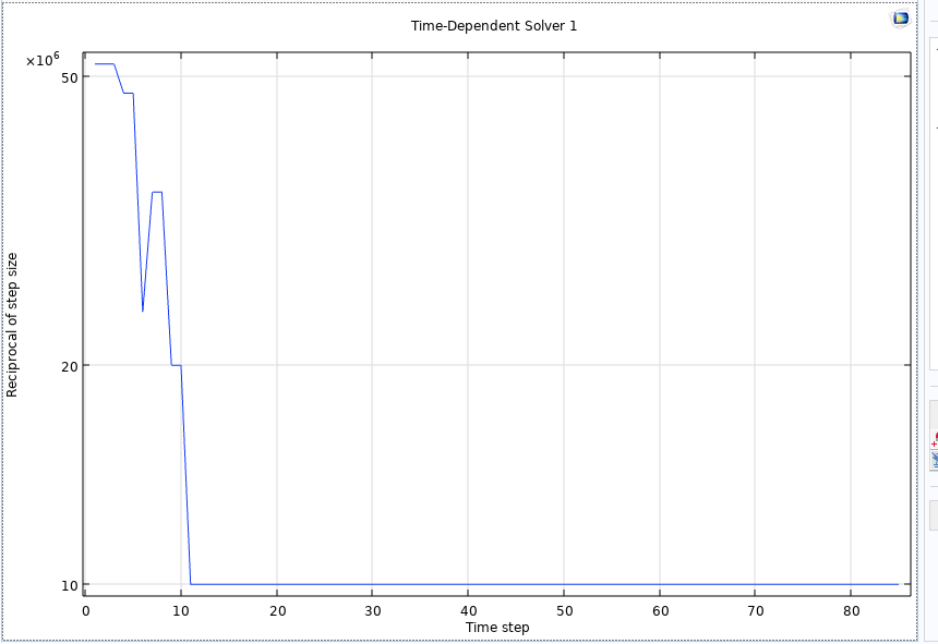

Dear Sir,
Thank you very much for your guidance.
Even after using the Solid Conductor settings with a sinusoidal voltage excitation, the convergence plot is becoming constant instead of converging. I am unsure why the solver is behaving this way.

Anushka,
the solver is performing as expected. You set a strict time step of 1e-7 s and the time stepping converges to an inverse time step of 1e7 and remains there. That is how it is to be expected. Now let it run for the 5e-5 s you set.
